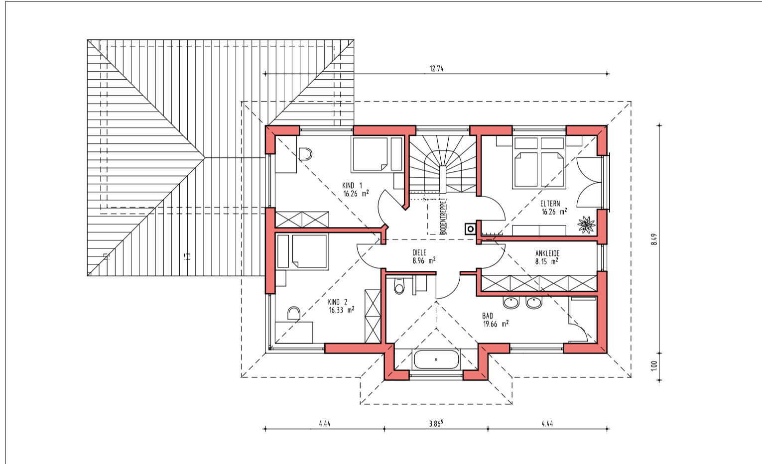

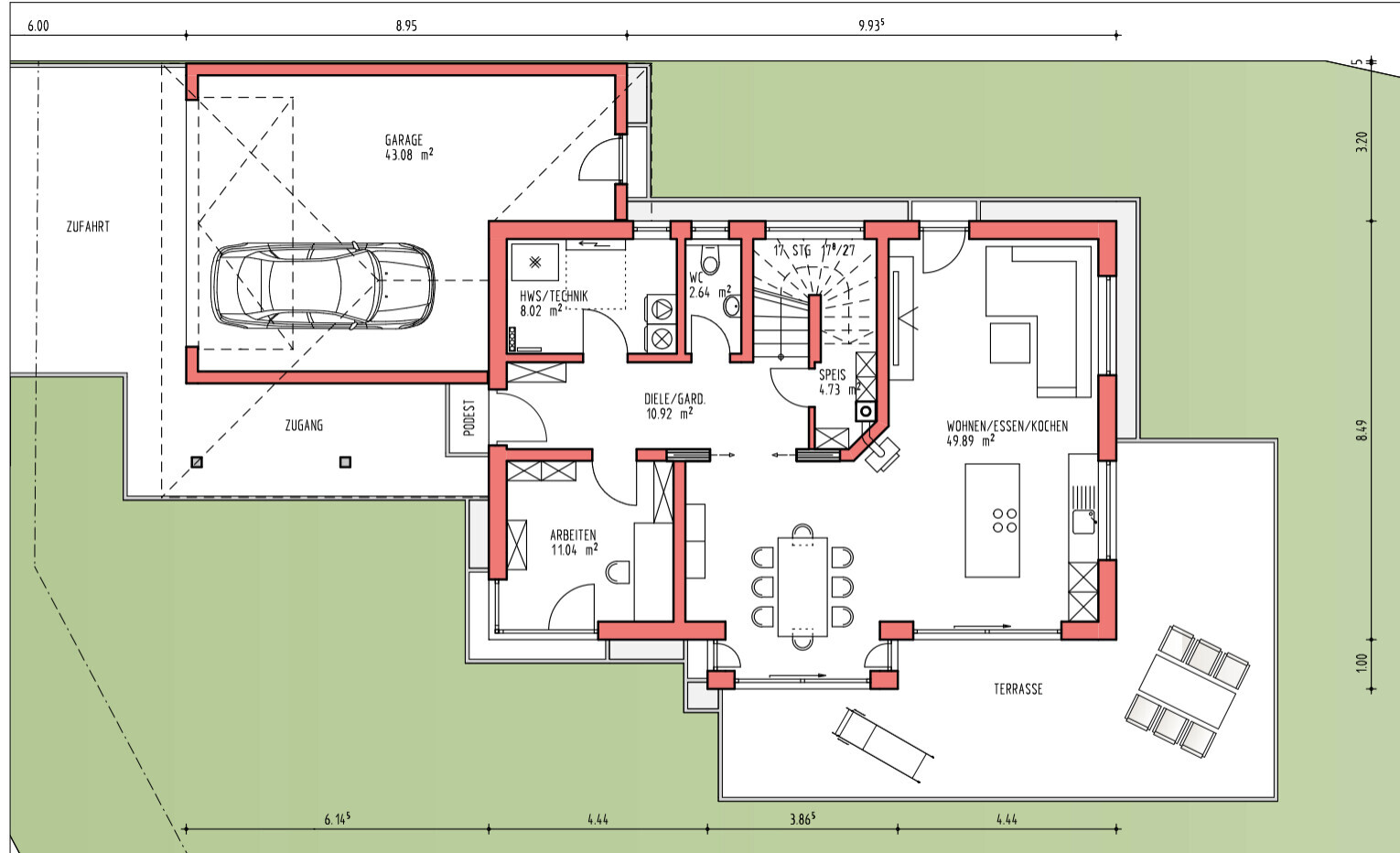

Matze90Hello everyone,
Our design is now quite advanced, so we hardly see any points that still need to be changed. I am actually quite impressed with the design.
I am sure there are some people here in the forum who might still have ideas or see issues with the plan. I would really appreciate your feedback.

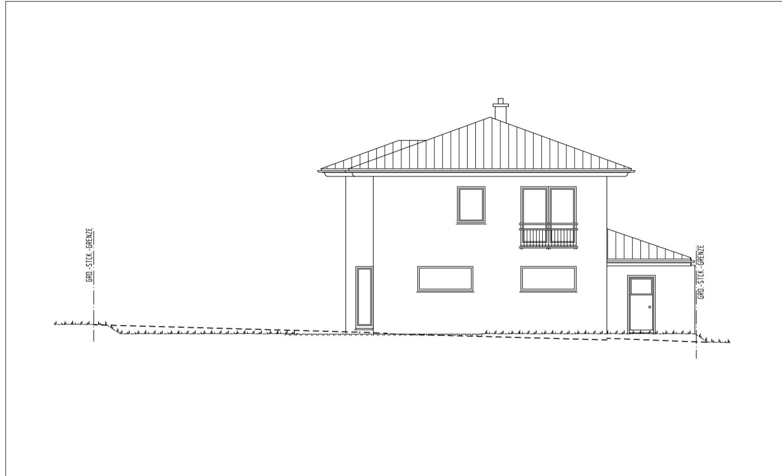

To be honest, I actually like it. Having the kitchen next to the sofa takes some getting used to, but I still like it. The rooms upstairs also work – okay, the sloped ceilings aren’t for everyone, but I think they’re fine. The utility/storage room is really tight. That’s definitely too small. Wouldn’t you rather sacrifice part of the garage to expand it? That would also be very useful if you could simultaneously deepen the wardrobe area. That’s too shallow as well. Adding a few sliding doors might create some extra space, but overall the closet needs to be deeper.

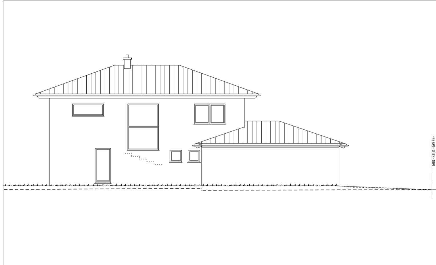

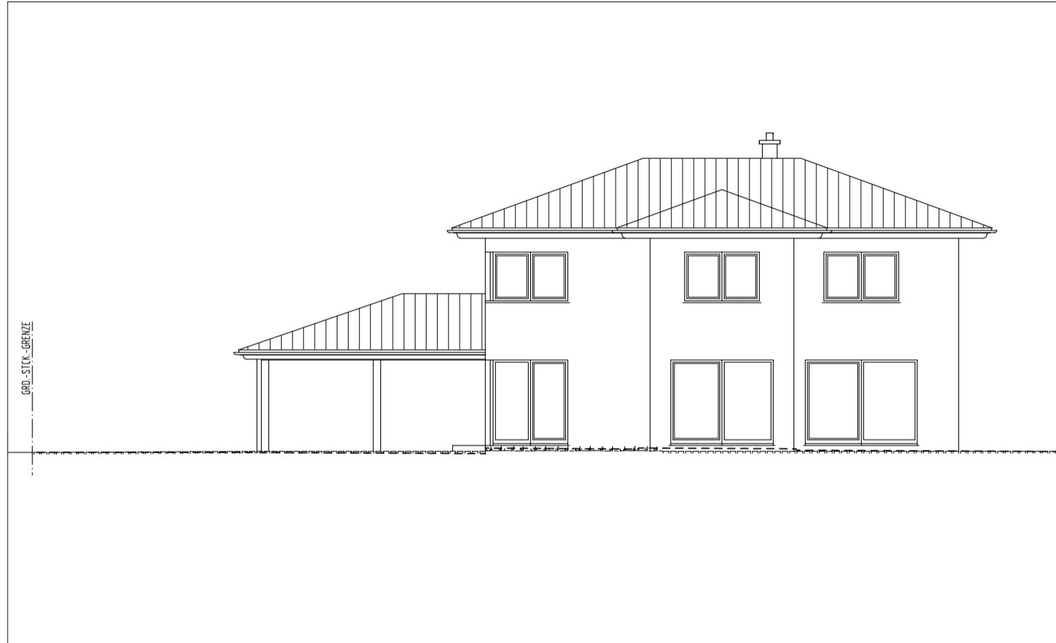

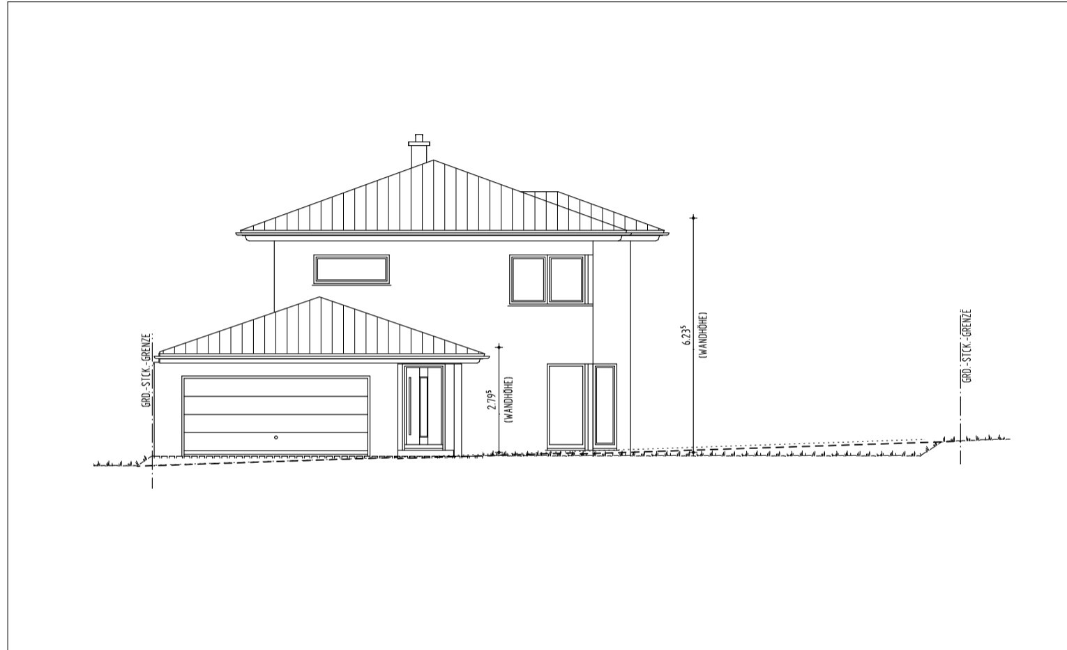

The elevations are an absolute disaster. They need to look nicer! It should also look good from the outside.

The house could have been oriented differently to allow more southwest and west sunlight into the living areas. However, there is a lack of storage space. The kitchen is smaller than what the two of us have, and we have reached a point where nothing more can be added.
On the other hand, the bathroom is far too large. It feels uncomfortable. The sink is placed with daylight behind you, and the bathtub is positioned as a showpiece rather than for relaxing.
It will work, though (as long as you regularly declutter).
NatureSys22 Nov 2019 21:00Two small details:
1. In the dining room, I would make the two small floor-to-ceiling windows fixed elements. This is more cost-effective and allows for slimmer frames. The doors would be so narrow anyway that they wouldn’t really be used.
2. In a bathroom this large, I would always install a urinal.
Thank you in advance for the answers. Some useful tips may already have been included.
Sliding the door from the utility room is already a good tip. That could allow the closet to be a bit longer. The washing machine would still fit behind it. I hadn’t thought of that myself.
Basically, I looked at a similar room and found it sufficient, even though an additional 3 sqm (32 sq ft) wouldn’t hurt.
What exactly do you mean by the elevations? Windows not perfectly aligned vertically? Would you perhaps have a suggestion?
The kitchen is about the same size as ours, which, although already quite full, is still sufficient. I had planned to store dishes and so on along the wall in the dining area in a sideboard or cabinet. That should actually provide more space and be enough for now.
I believe/hope that the bathroom’s shape will prevent it from feeling too large. The daylight behind the sink is potentially a good point. I’ll have to test whether that might be annoying for me. I personally find the bathtub situation acceptable.
1. That certainly makes sense, thanks! I’m even inclined to remove them completely!?
2. That’s definitely worth considering. Although this will only be decided in the detailed bathroom planning. I’ll keep it in mind.
