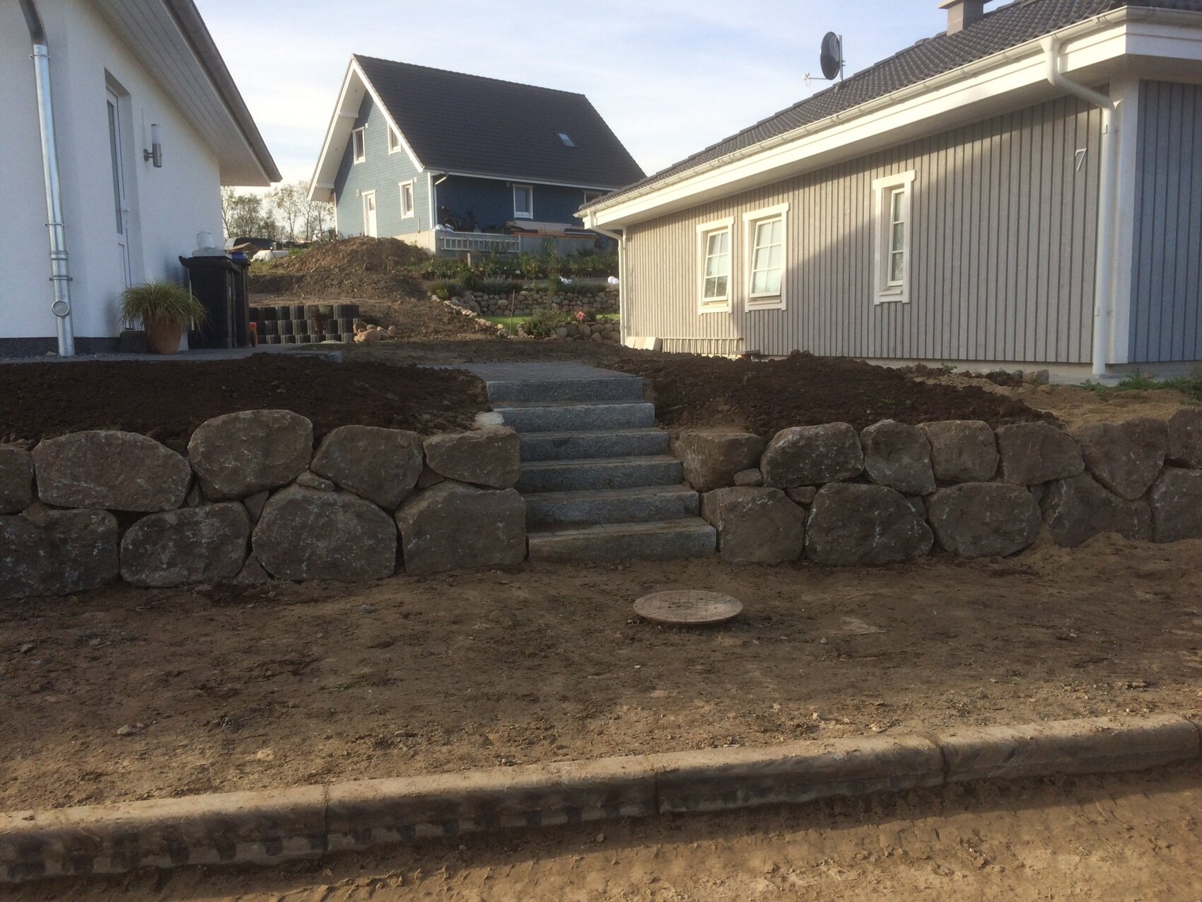

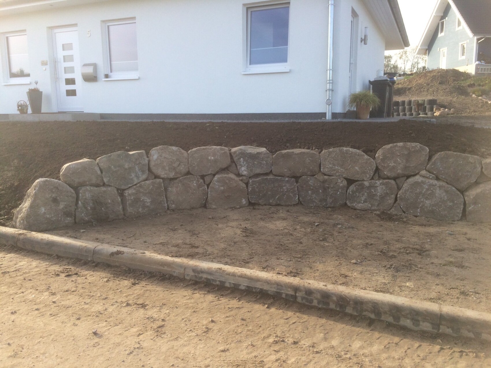

DTvomHaus19 Aug 2018 16:18Thank you for your response. Does that include the concrete foundation? And do you have any photos of the result? Best regards and have a great weekend.
@Nordlys you more or less got the stones for free, from a cemetery or somewhere else?
Normally, 1 ton costs around 80-100 euros, which is about 1 meter (3.3 feet) of a 50x50cm (20x20 inches) block.
Labor costs are about right, though usually higher depending on the region.
You can roughly calculate the rest yourself.
