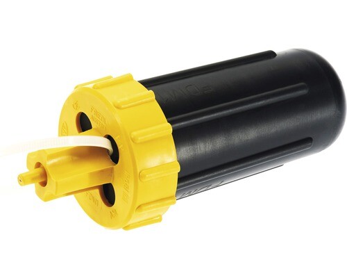

Alessandro25 Nov 2020 07:56How can you seal a distribution box that is going to be buried in the ground?
The landscapers say it should be cast with resin, but then I would never be able to access it again if I need to rewire something.
Does anyone have any ideas?
Alessandro25 Nov 2020 07:59No, that won’t work. Due to the moisture inside the box, it will start to sweat and condensate. I can well imagine using a heat shrink tube.
nordanney25 Nov 2020 10:45Mycraft schrieb:
Why not use a junction box suitable for underground installation? For example, the well-known universal coupling.Maybe we are allowed to mention a name: Friedl. They are reasonably priced and provide a reliable seal in soil (personal experience). Available in various sizes.
