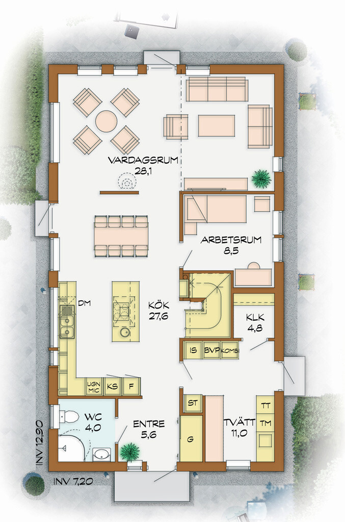

For example, something like this (dimensions: 8.10 m x 13.15 m). Discovered again at Viebrockhaus.
Sorry, NORTH is at the bottom here! Please mentally rotate the plan 180 degrees.
This would allow a south terrace with good privacy screening.
The only thing I would still consider is swapping the bedrooms for sleeping and children regarding orientation, but I don’t have a good idea yet.

I like your basic idea regarding the location and would also have the house accessed from the north (entrance).
I remember a house design that is similar but narrower, with a rotated staircase. The utility room would replace the office.
For Viebrockhaus, I would give the office an extra 50cm (20 inches) in width.
What about this: could you consider placing the kitchen towards the back and the living room at the front instead? In the evening, you’d probably spend more time in the kitchen connected to the terrace...?Hi,
Giving more width to the office is an option; I’ll discuss that.
Swapping the kitchen and living room hadn’t occurred to me… what do you mean by “connected”?
Since it’s not an open-plan kitchen, I’d expect to spend evenings in the living room rather than the kitchen.
