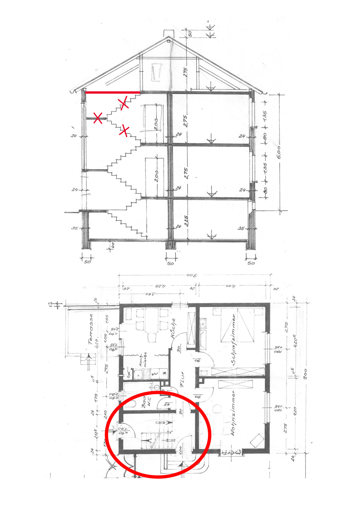

That said, here is my question. The house has two floors, a basement, and the attic is planned to be converted. The stairwell, located to the left of the main entrance, leads to the basement and the upper floor. In 1961, the architect planned to extend the landing staircase all the way up to the attic, but this was never carried out. The attic floor was concreted. We would like to finish this idea by partially breaking through the concrete ceiling (appointment with the structural engineer on 16.03) to extend the stairs upwards.
The staircase is a concrete landing staircase with a steel balustrade. There is about 14cm (5.5 inches) of space between the flight runs. My wife now wants to remove the balustrade and instead build a wall from the basement all the way up to the pitched roof, because, as she says, it looks NICE.

Recently, I treated my family to the purchase of a house. I had no idea that this would develop into a building project where my wife takes the lead in implementing all kinds of ideas, some of which were never even thought of before.
The question is... how?
