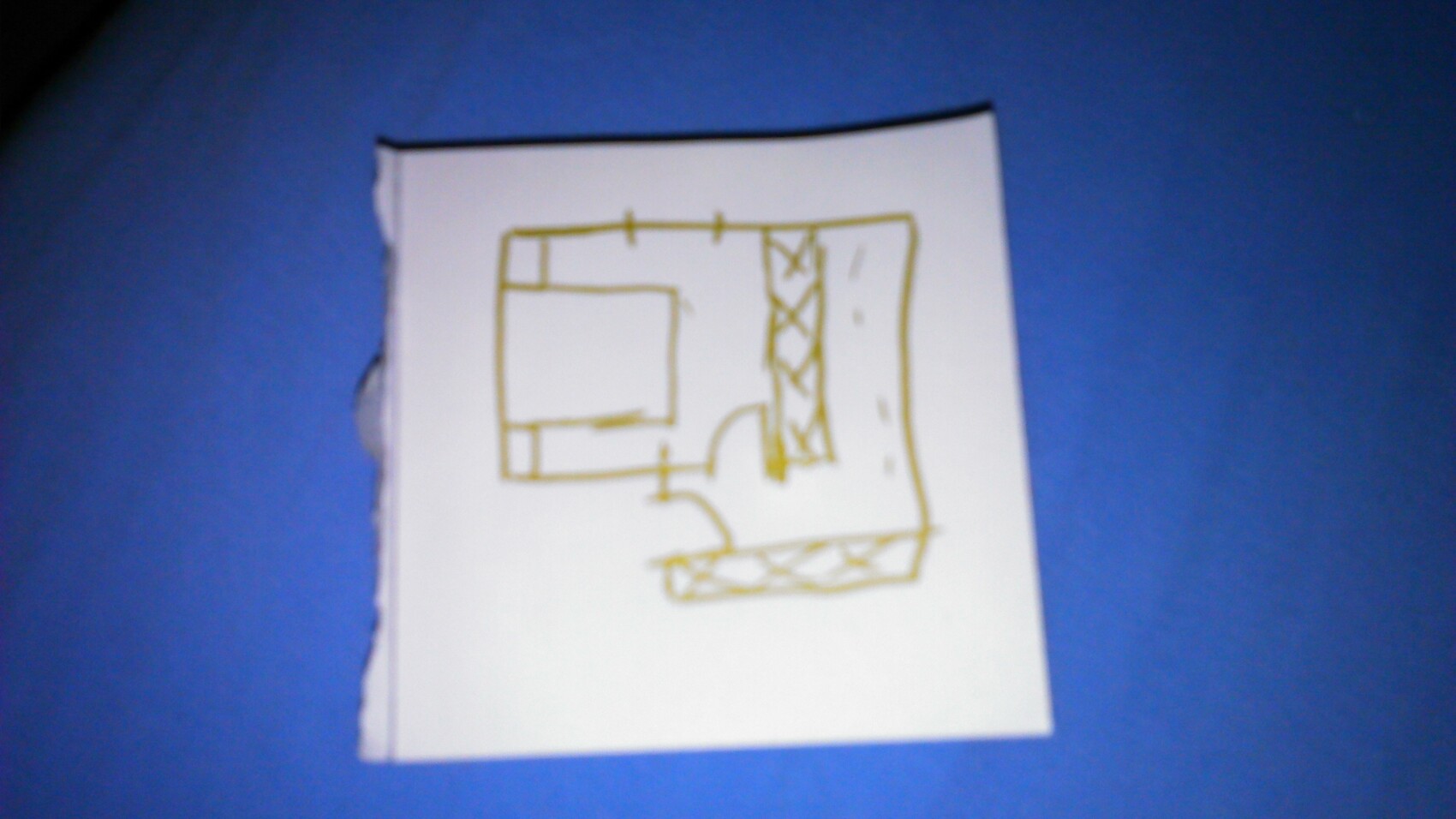

Regarding your bedroom layout: What do you think about closing the bedroom door and accessing the sleeping area through the walk-in closet? I would then place the bed on the other side and plan the walk-in closet larger, extending around the corner or something like that. I’m not sure if the space works out that way, but I roughly sketched what I had in mind. 🙂
