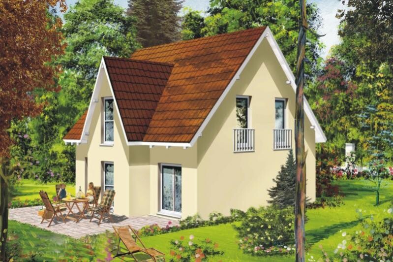

I find the figures from Bauexperte at around 1190 €/m² (approximately $130 per sq ft) to be quite low.
That’s not much of a house and is close to the standard for a Massa house (1150 €/m²).
However, this is not yet a KfW 70 energy-efficient house with a basement. Given the budget, it’s likely a shell finished as a turnkey build with self-completion.
Why include a basement at all if the financing is tight?
The BAFA grant or the KfW funding would, of course, be a bonus.
Well, it’s doable, but only with a large portion of self-completion work.
I would only dare to manage a project like this with tradespeople acting as the builders.
The material costs for the self-completion part can probably be negotiated into the finishing package with some skill.

Bauexperte18 Aug 2010 10:45@ Parcus
I don’t want to risk sounding like “paper is patient.” Attached you’ll find an animation of the house in question (ad-free), which as a KfW 70 energy-efficient house results in the stated fixed price: finished without a basement and built conventionally with aerated concrete, in the “turnkey” version. In this option, the builder still handles the finishing trades such as painting and flooring.
When I share my experience with prospective homeowners here, they can be sure I’m not dealing in castles in the air.
