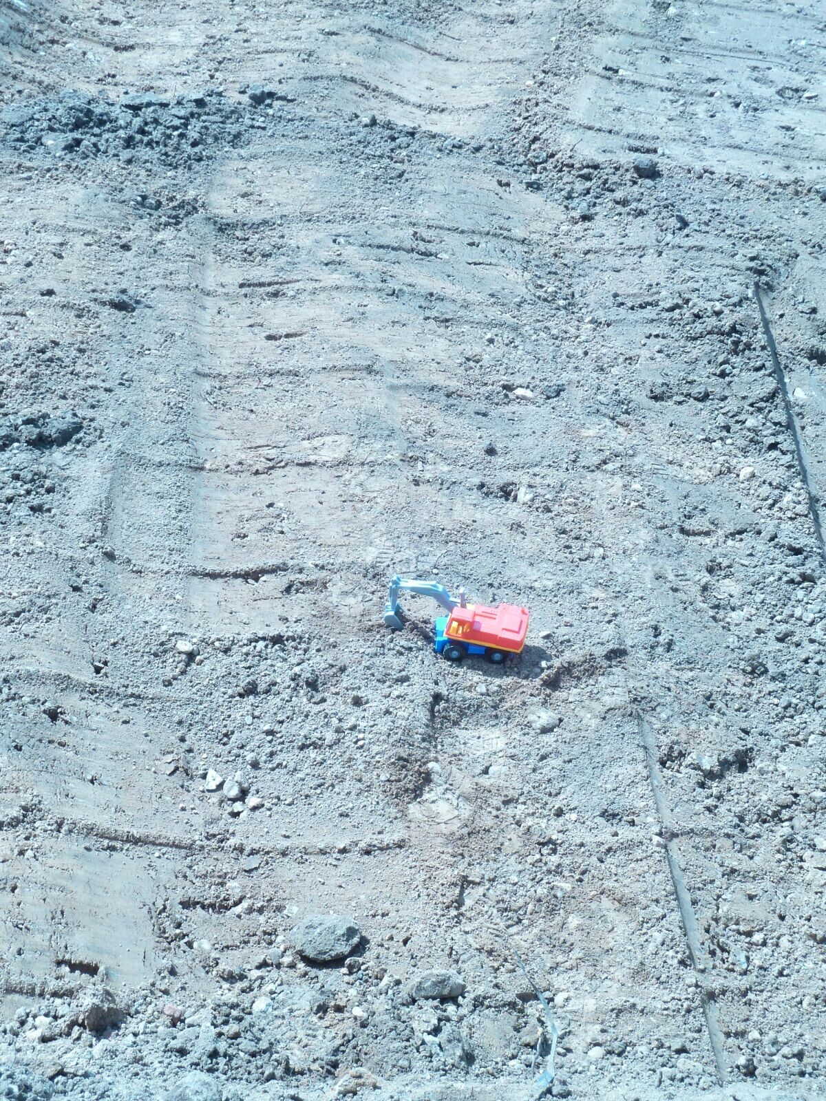

MarcWen18 Jul 2016 18:49
Today was the big day, the groundbreaking. I couldn’t be there myself, but my wife was able to take a few pictures.
So, who can spot the mistake? 🙂
Small colorful toy excavator lying on dusty construction ground
