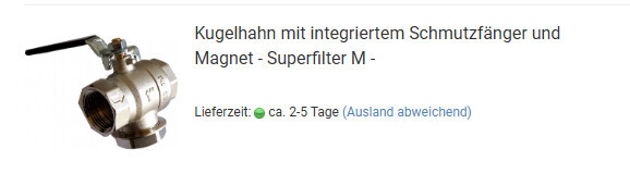

What type of system do you have? For some manufacturers, it is mandatory; others consider it optional.
Mud basically means a "magnetite separator," which removes magnetic material to prevent damage to the pump. With modern composite pipes, this should hardly occur anymore. And if it does, in my opinion, a simple magnetic separator is sufficient:
Ball valve with integrated dirt trap and magnet – Superfilter M
Regarding microbubbles: At the usual supply temperatures below 30°C (86°F) for most of the year (in new buildings), it is questionable whether enough micro gas bubbles can form at all. In three years with two heat pumps, I haven’t found any—though this is not representative.
