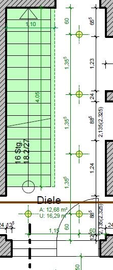

I have a quick question regarding my floor plan. The image is attached.
The issue, if I may call it that:
The room in front of the staircase (on the ground floor) feels a bit too large to me. From the first step to the exterior wall, it measures 1.57m (5.1 feet). My idea is to move the lower exterior wall slightly upward towards the stairs, but only the wall. Everything else should remain as is. I am aware of the consequences regarding the sizes of the other rooms. The utility room to the left can be smaller. The guest WC can also be made a bit narrower. The shower could be recessed upward into the guest room, possibly halfway—meaning half of the shower would be a niche within the guest room. This way, the guest WC becomes narrower.
Is it possible to move the exterior wall about 50cm (20 inches) upward? I think the main challenge might be the door opening. But wouldn’t 1.07m (3.5 feet) be enough to open the door? The door to the guest WC could also be shifted a few centimeters upward towards the guest room. I have seen floor plans with dimensions where there was only 1.00m (3.3 feet) between the exterior wall and the start of the stairs.
The house has 163m² (1,755 sq ft), and we want to downsize a bit. We see potential for savings here.

sauerpeter2 Sep 2016 15:21@Jochen104 could you please post a picture of your staircase?
What is the ratio between the riser and tread in your case?
