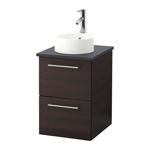

Sektionschef14 Sep 2014 23:34Hello
I am interested in this Godmorgon vanity cabinet:
Godmorgon / TOLKEN / GUTVIKEN
Vanity cabinet + countertop sink 29, black-brown, anthracite
After reviewing the assembly instructions, it is unclear to me at what height the vanity cabinet should be installed.
The instructions specify a minimum height of 73.5cm (29 inches) and a maximum of 76cm (30 inches).
On page 15, it is mentioned that the Godmorgon legs can also be installed.
On the Ikea website, I only found this leg:
GODMORGON
Leg, round, stainless steel
It is adjustable from 22cm to 25cm (9 to 10 inches).
The cabinet itself has a height of 58cm (23 inches).
So the minimum total height would already be 22 + 58 = 80cm (31.5 inches)!
However, the assembly instructions for the Godmorgon legs show both short and long legs, so there might be shorter legs available for the vanity cabinet?
Do these actually exist and what is their height?
In general, I probably won’t use any legs. If so, do I still need to comply with the maximum installation height of 76cm (30 inches)?
I would like to install it a bit higher, around 80cm (31.5 inches).
Does anyone see any issues with this height?

IKEA-Experte15 Sep 2014 14:04GODMORGON/ TOLKEN / GUTVIKEN
Hello, it might be that only the connection hoses of the fittings are too short if you install the washbasin higher. However, this can also happen at the specified height. In that case, you simply extend the connections.
