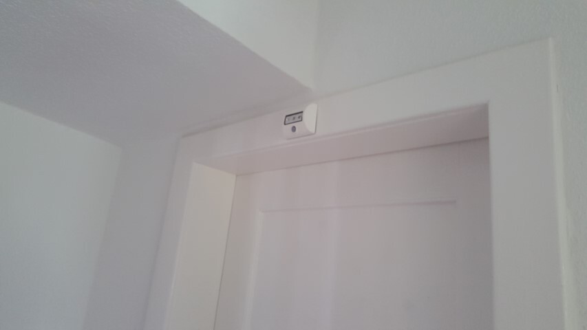

I installed a Gira Sensotec for exactly this purpose in our upstairs hallway, which meets your requirements except for the timing phase (assuming the LEDs are dimmable).
