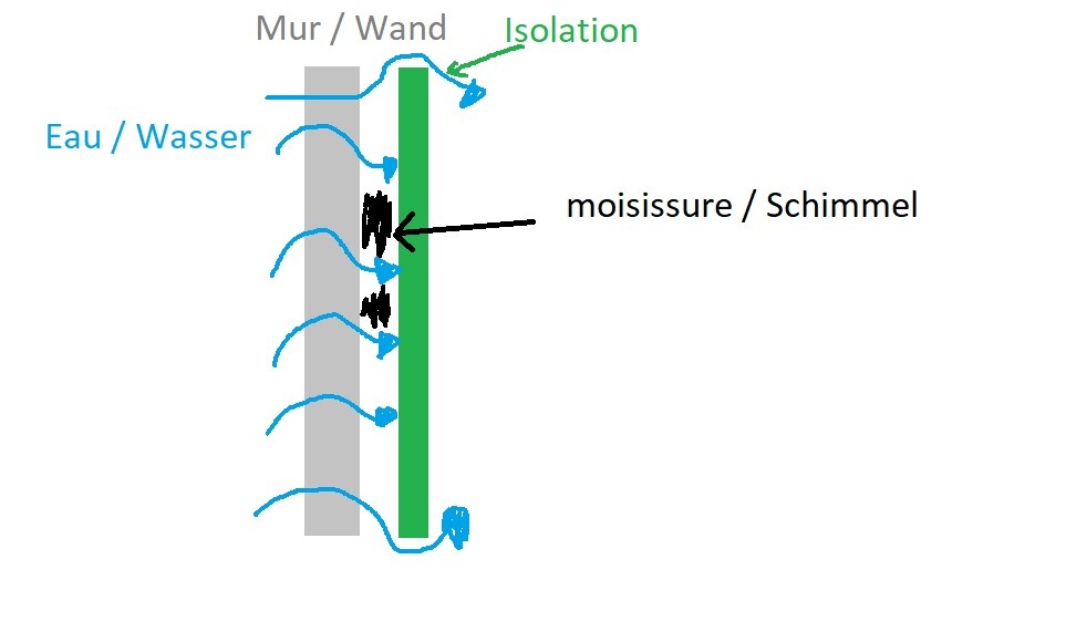

Do you think it makes sense to remove the insulation to leave the walls exposed and prevent moisture buildup between the wall and the insulation?

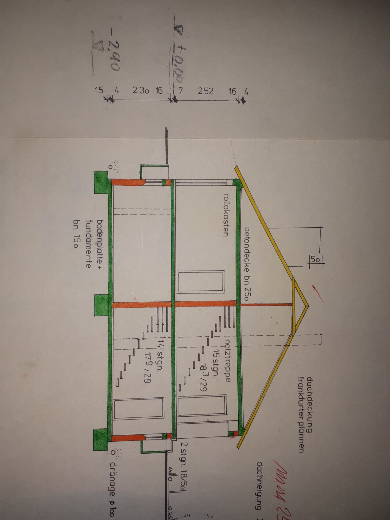

I believe the waterproofing of the exterior walls (KSL 150 / 1.6) on the outside is no longer in good condition (the house was built in 1976).
The property is flat and does not have a well or similar installations.
There is also a 100 mm (4 inches) drainage system around the house (which may need cleaning).

I think the insulation of the exterior wall may no longer be in good condition after all these years. And through sufficient ventilation and removal of the internal insulation, the walls might be able to manage moisture better / “breathe” more effectively?
