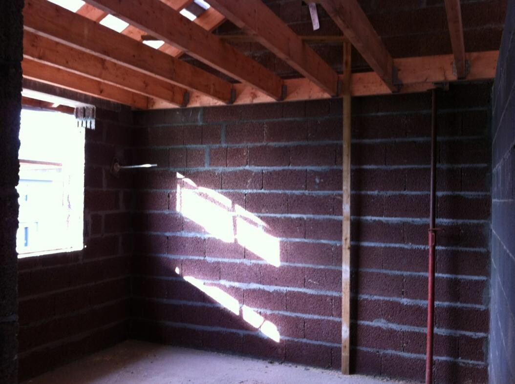

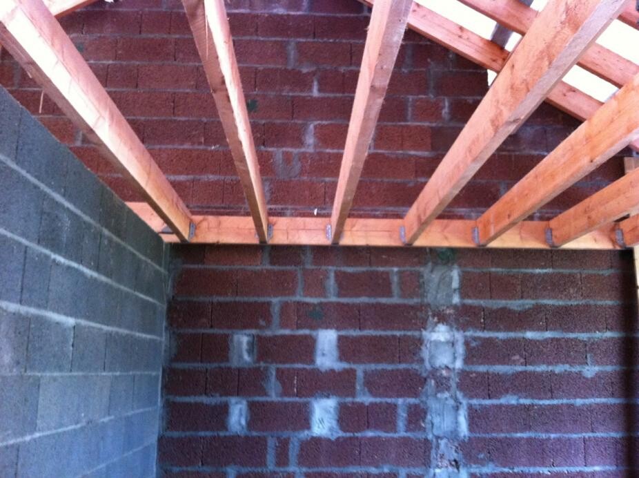

JohnnyChicago22 Jan 2013 16:47Here you can see the roof structure in the shell stage.
This is not a ring beam.
The roof is designed as a cold roof.
The insulation is placed on the floor of the attic.
There is no insulation between the masonry and the beam.
Is it possible that warm air from the room condenses on the cold wall in the attic area?
A vapor barrier, in the form of a blue foil, is installed up to the beam (the insulation lies on top of this foil).
The ceilings of the rooms below the attic are about 5cm (2 inches) thick but are not designed as load-bearing ceilings, meaning the attic cannot be converted into living space.

JohnnyChicago22 Jan 2013 16:51Hello Johnny,
Actually, there shouldn’t be any thermal bridge issues there (bisotherm), although I generally find this solution with the collar beam level rather unappealing. My guess is holes in the vapor retarder, but more likely: the vapor retarder was not properly sealed or plastered over! This allows warm, moist air to condense on the cold surface. Tip: open a small area of plaster and take a look. According to DIN standards, the foil must be glued (using a special flexible adhesive, not acrylic) and the plaster should be reinforced with fabric mesh or expanded metal...
B. Botermann29 Apr 2013 12:32Homis’ comment sounds very reasonable: I also believe that the vapor retarder was not installed properly.
