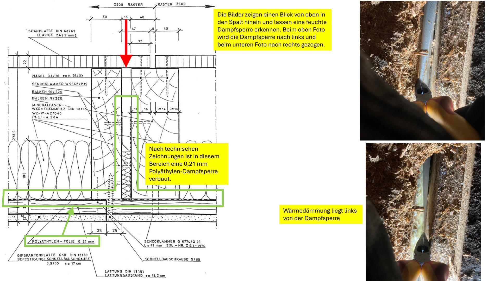

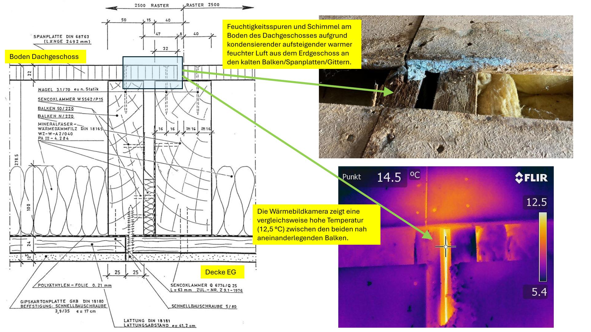

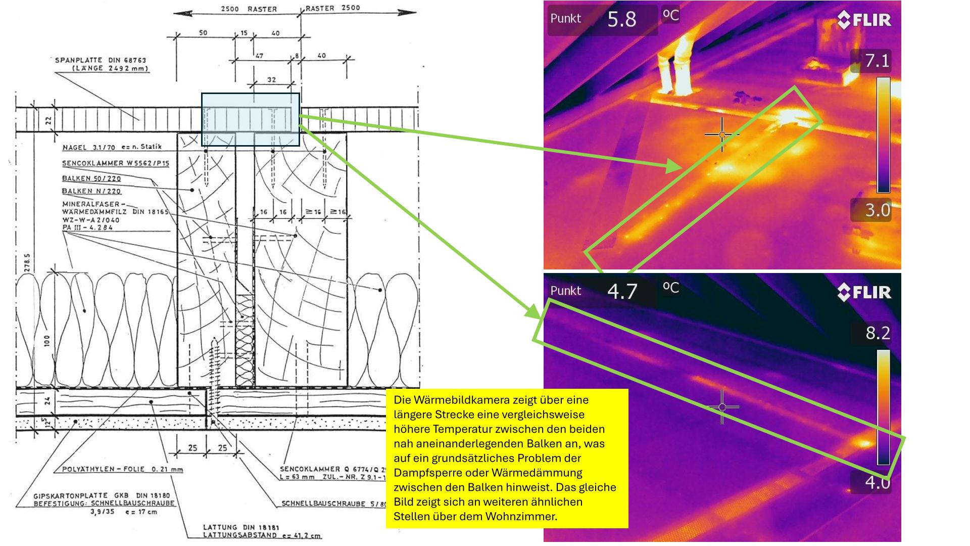

Last year, we purchased a Weberhaus prefabricated house built with a timber frame construction (built in 1987). This winter, we discovered moisture marks along a line on the floor of the unheated attic. The structure is a wooden beam ceiling with ventilation, featuring ventilation slots approximately 10cm wide (4 inches). The most pronounced moisture marks are located above the bathroom.
I have already conducted a thorough analysis of the problem based on the aspects I am familiar with and have compiled the findings:
Note: The gap approximately 10 cm wide (4 inches) shown in the photos is the ventilation slot, which is normally covered with a metal grille.

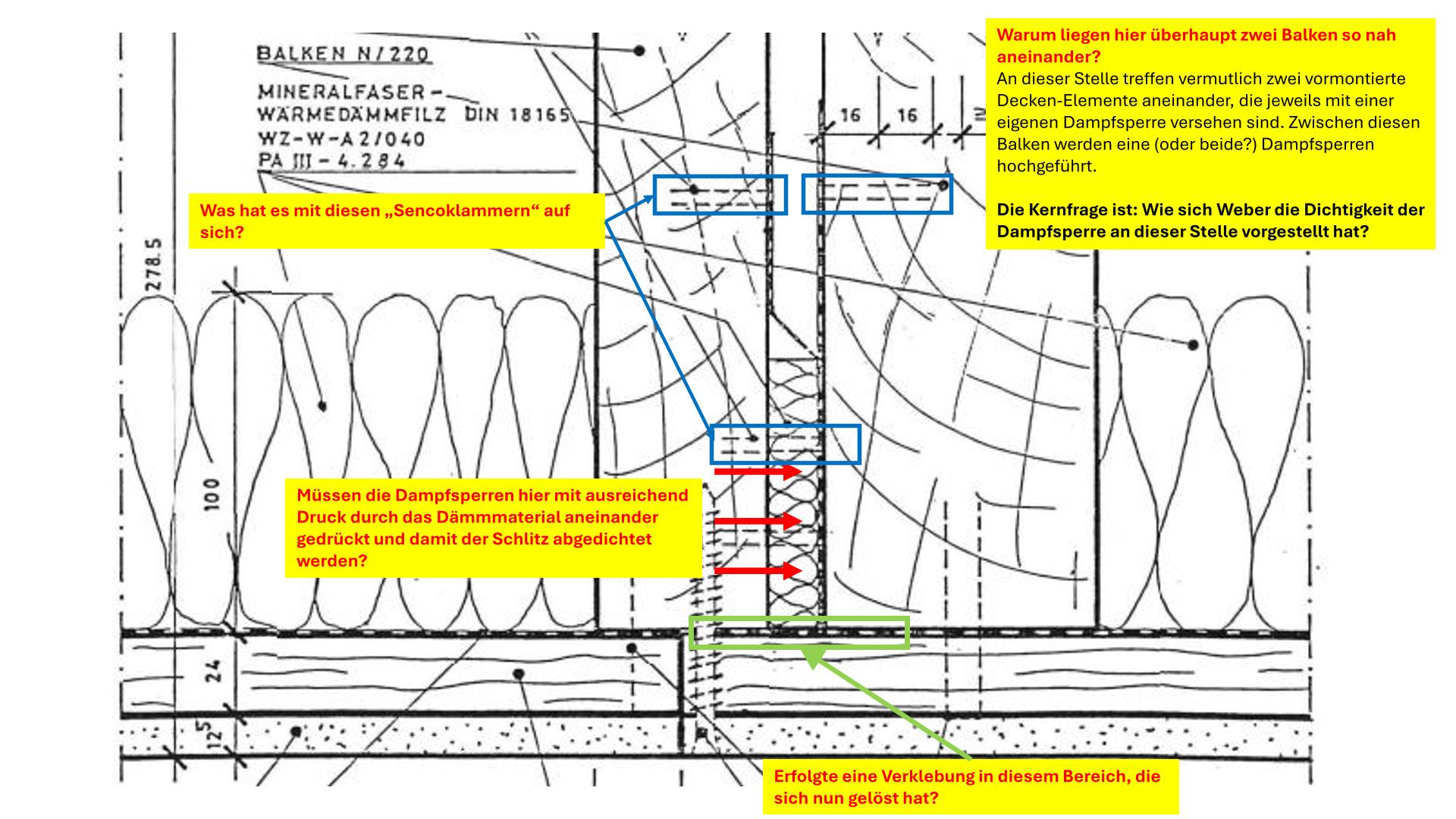

It is clear that timely action is required. We are planning to increase the insulation of the top floor ceiling anyway. Converting the attic into a living space would be ideal, but is not financially feasible in the coming years. So, the attic is to remain unheated. Before developing a specific plan, I need certainty about how to deal with the moisture issue between the ceiling elements, meaning the closely spaced beams with an upward race of PE foil should be handled.
The affected area is mostly underneath the bathroom. I am already considering removing the entire ceiling assembly, including the existing PE foil, and rebuilding it to current new-build standards (as explained in the linked video below). This would at least provide good sealing towards the ceiling in the bathroom area. However, since these “problem areas” extend across multiple rooms separated by walls, a full replacement of the ceiling structure from below cannot be carried out everywhere. Are there alternative ideas on how this problem could be effectively addressed “from above”?
