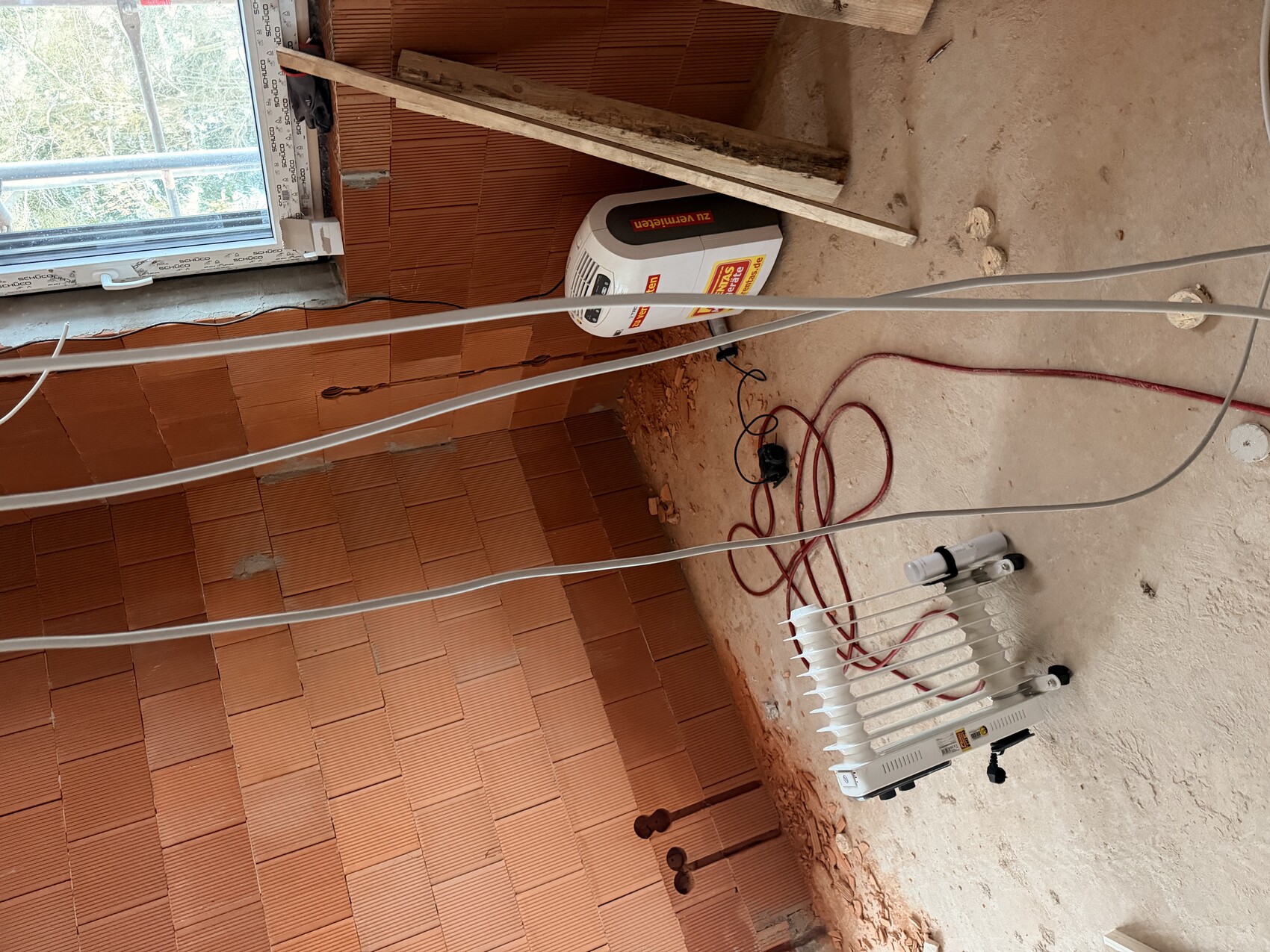

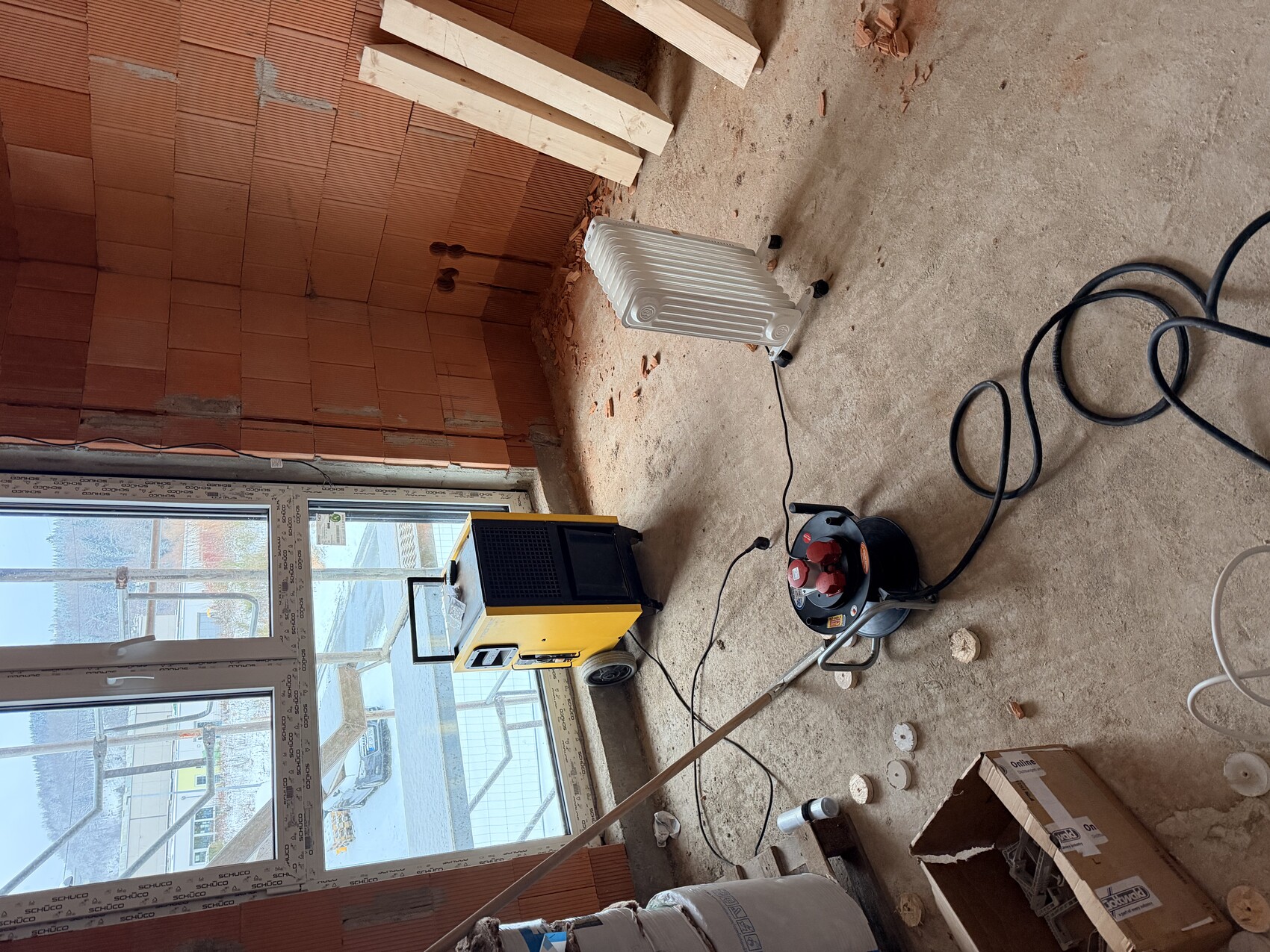

Currently, I have one dehumidifier and a 2 kW heater in each of the two children’s rooms. Twice a day, I empty about three quarters of the water tank.

How is the weather at the moment? As long as there is no severe frost, I would recommend alternating between thorough ventilation and immediately running the dehumidifier afterward. Don’t worry about any cracks. Normal shrinkage cracks at material joints are almost unavoidable. Just today, after nearly two years, I noticed a new shrinkage crack in the interior plaster. With the ongoing cold, constant heating, and 24/7 ventilation, the humidity drops significantly, and the last bit of moisture escapes.

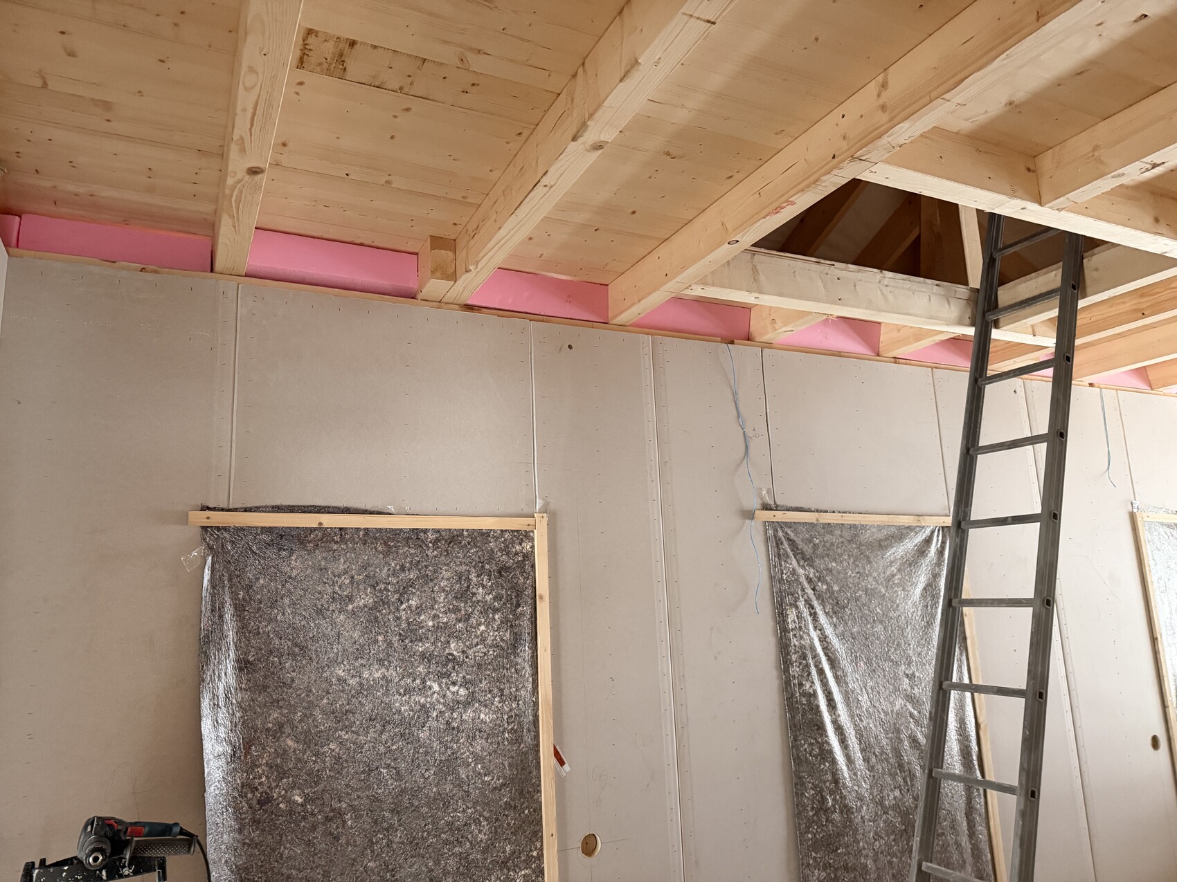

I see an opening toward the attic? Is that a cold roof? If so, you should definitely temporarily seal it with an XPS board before plastering or applying the screed. Otherwise, moisture will rise during heating and condense there, which usually leads to mold.

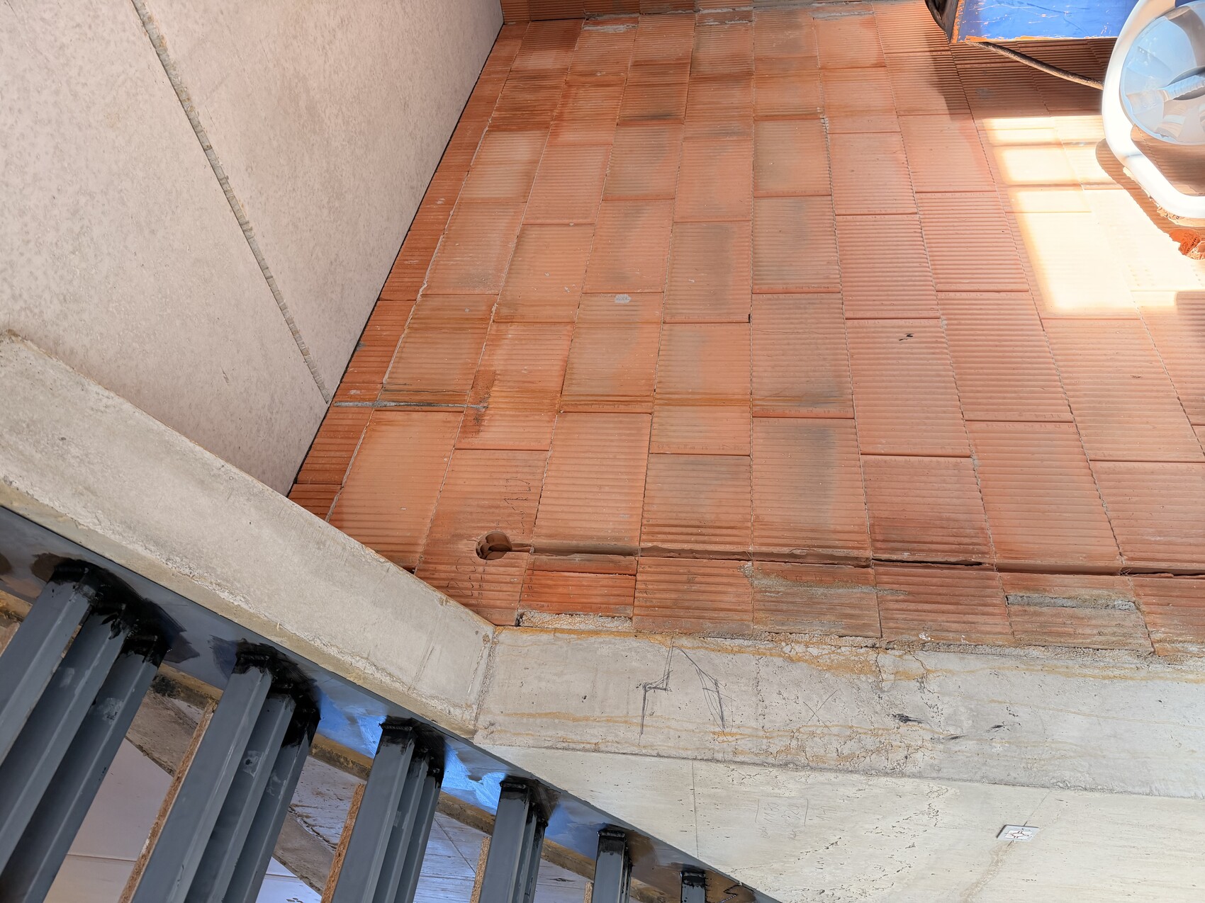

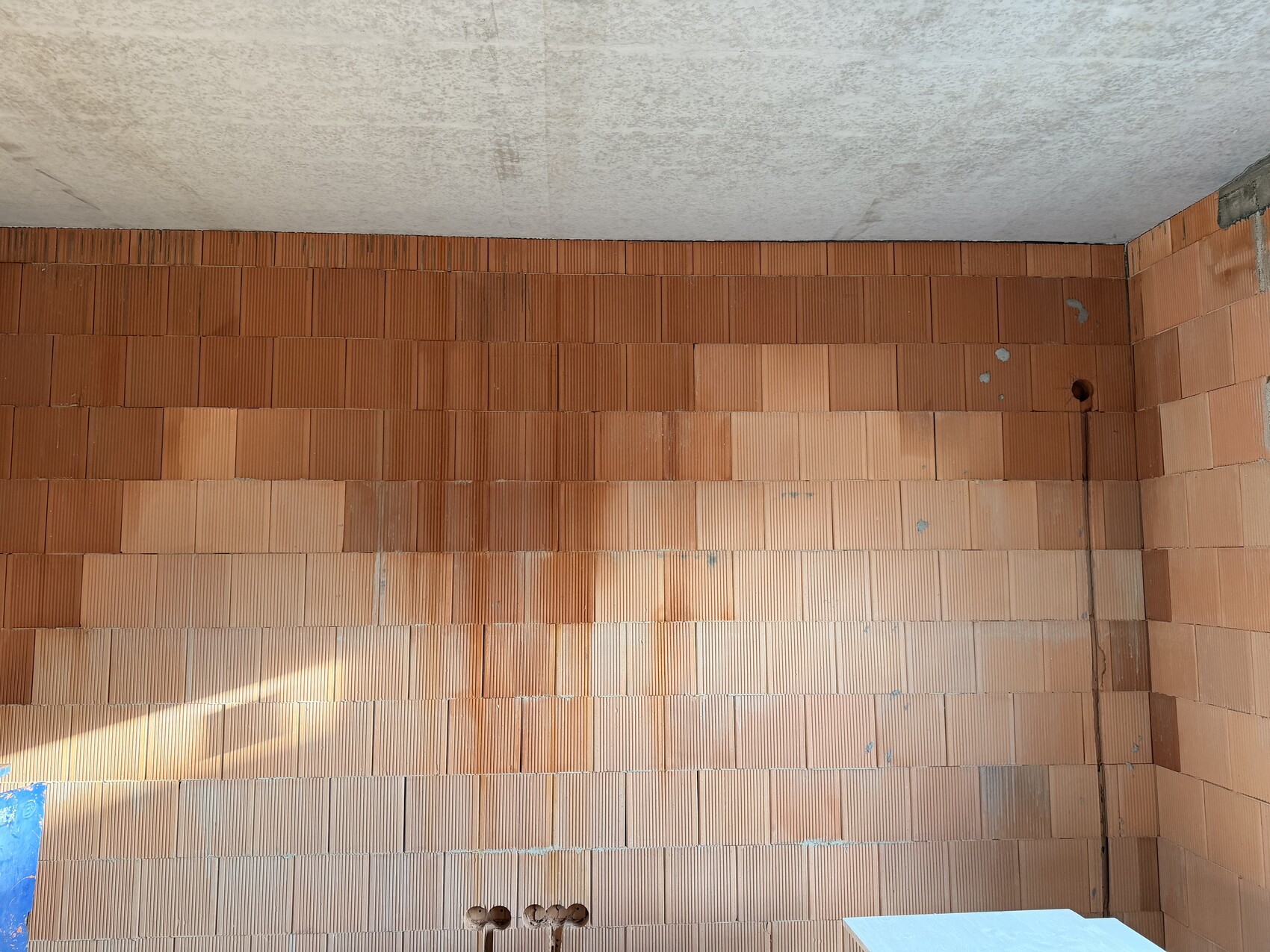

Back to your damp bricks. Our garage wall looked exactly like the wall in your photo. However, this did not affect the plastering. Everything will dry out over time. In addition to the dehumidifier, I used a few fans to keep the air moving inside the house and directed toward the dehumidifier. This way, mold hardly has a chance to ever find "suitable conditions."

I see an opening towards the attic? There will be a folding attic ladder at that opening. I also plan to insulate both the roof pitch and the ceiling on the upper floor. Then I will finish with a drywall panel. Should I do all that before plastering?
Besides the dehumidifier, I also used a few fans to keep the air moving inside the house I’m also trying to work with two dehumidifiers to create circulation. But what Tomtom79 said also makes sense. Plastering definitely brings a lot of moisture into the house.

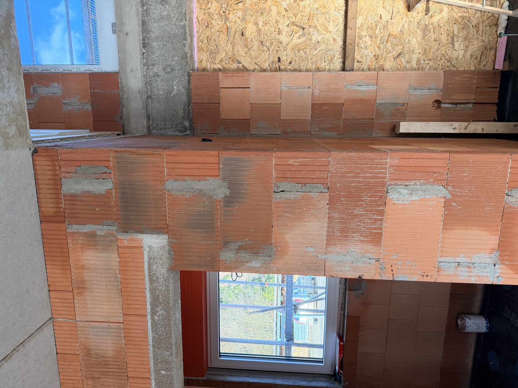

The Wienenberger T9 hollow bricks without filling definitely need to be covered, according to the datasheet. Especially at below-freezing temperatures, water can cause the bricks to crack. Additionally, the water damages the structure of the bricks and weakens them.
