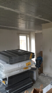

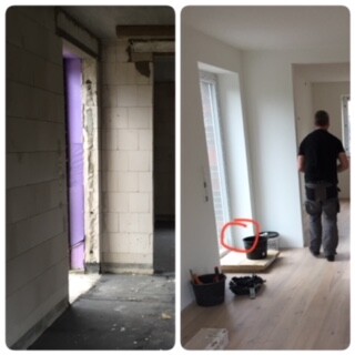

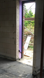

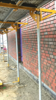

I will upload more pictures of the shell construction shortly (for now, I only have those of the ground floor available). The attic/gable photos will follow.

I will upload more pictures of the shell construction (currently, I only have those from the ground floor on hand). The attic/gable pictures will follow.
