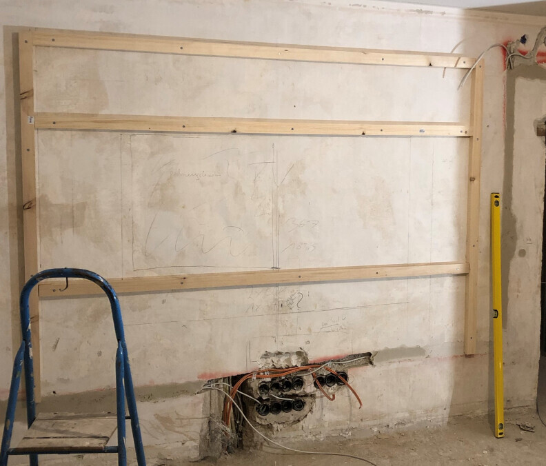

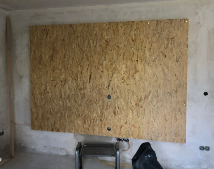

What was the wall panel mounted onto?
A sturdy subframe (60x40mm (2.4x1.6 inches) battens)
OSB boards (25mm (1 inch))
Slate tiles (1-2mm (0.04-0.08 inches) thick) - simply attached with tile adhesive
Cabling runs behind the panel (power, HDMI, network)

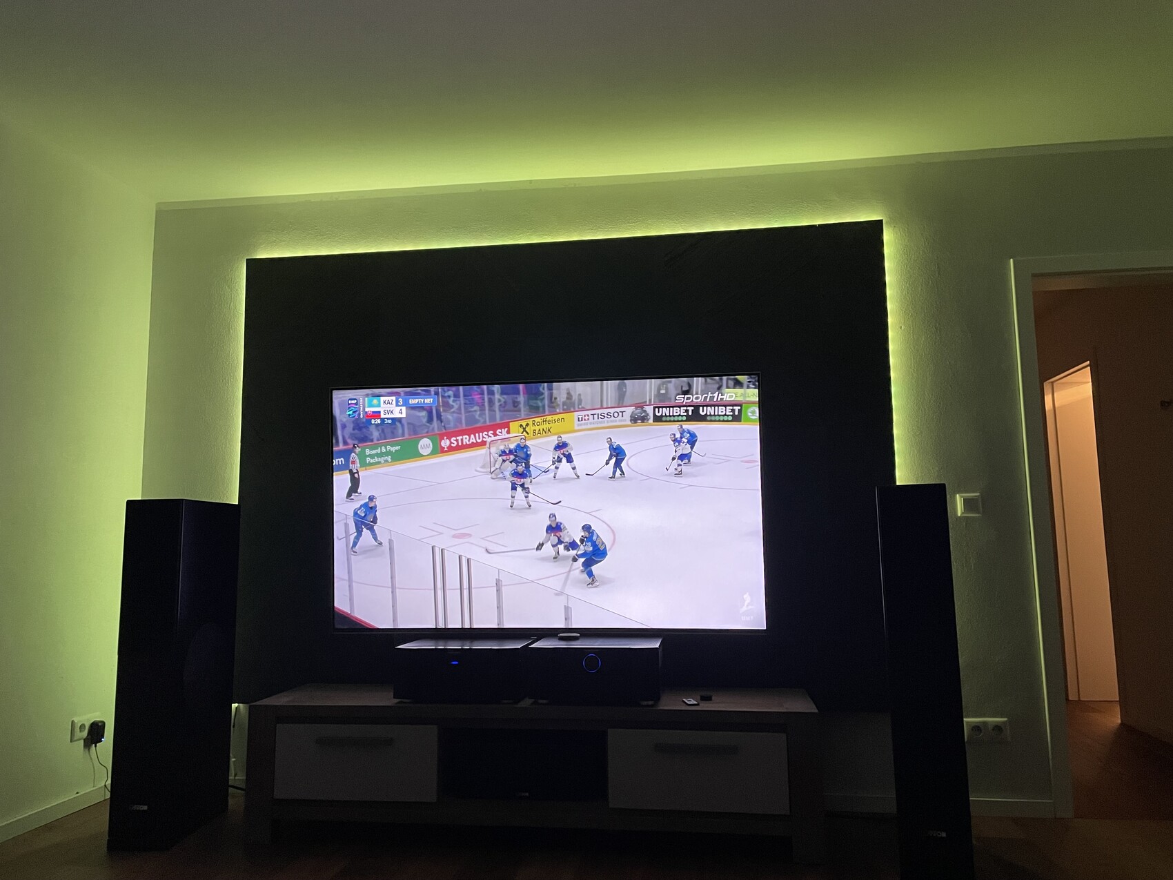

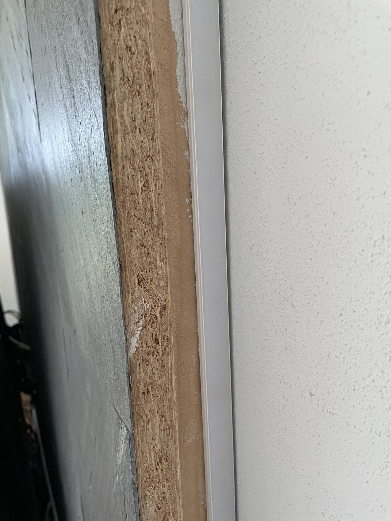

The OSB slightly protrudes at the edges (you can see this quite well in the third picture), as far as the strip for the LED strips
The slate tiles also extend slightly beyond, so thin strips can be glued on the side to completely cover the subframe (you can still access the strip for the LEDs, of course).
Bauwand mit Holzrahmen vor Beton; Kabel am Boden, blaue Leiter links, Wasserwaage rechts.

Color and brightness can, of course, be adjusted freely (it looks very bright here, but that is due to the photo). It is also possible (via an additional sensor) to match the color to the TV program, control it with Alexa or similar, and so on. Common LED strip technology.
