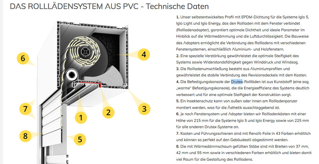

There are only one or two manufacturers that make smaller ones. However, due to the required height of the roller, the box ends up being quite shallow. One of these manufacturers is Europe’s largest window manufacturer, which also sells the most windows in Europe (see attachment). If the boxes were actually that shallow in design, this probably wouldn’t be a secret given their sales figures, or am I possibly missing something?
I don’t want to defend my preferred design blindly, but I’m just trying to understand the counterarguments. So far, I haven’t found any negative experiences online.
I know the manufacturer! I have shared my opinion and experience with you. We are talking about 8 cm (3 inches) and long-term use. The decision is yours! The manufacturer itself is not bad, but they cannot work around the geometries.
@guckuck2 This isn’t about what the market offers; I’m fully aware of that myself. The manufacturer must ensure that the roller fits inside the box given the chosen slat and the window height. Please make sure to read the posts fully.
