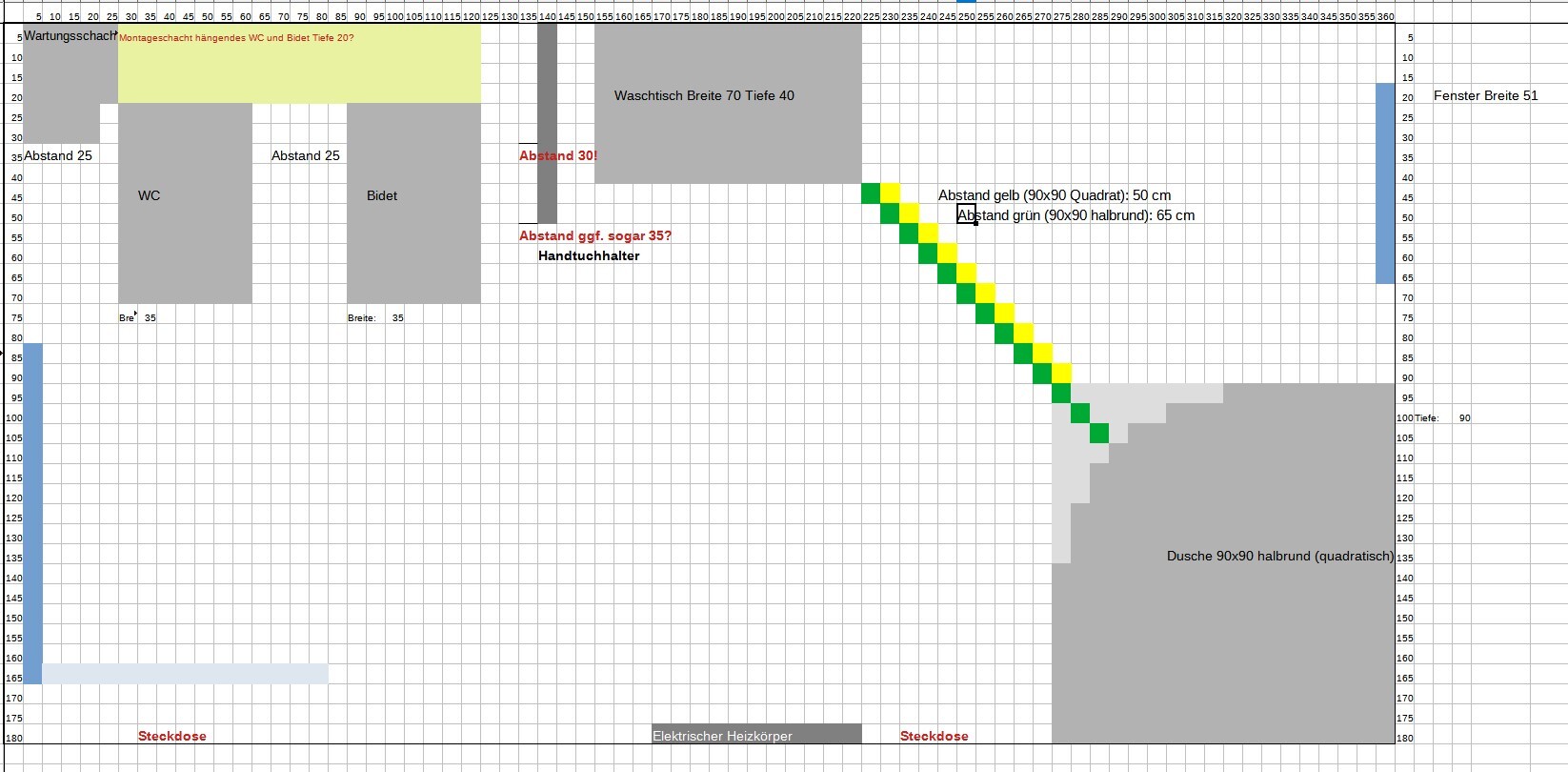

then show your dimensioned plan and where you imagine placing what.Thank you for your feedback! I wasn’t able to upload the plan earlier because I was not at my home computer. Here it is.
With a 70cm (28 inches) washbasin and a semicircular 90cm (35 inches) enclosure as in the plan, I should be on the safe side; with an 80cm (31 inches) washbasin, the remaining distance would only be 35cm (14 inches) according to the current layout. However, I am currently leaning more towards a square 90cm (35 inches) enclosure.

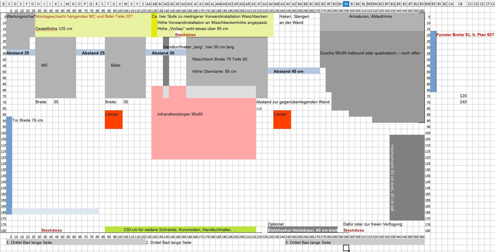

At first, we planned the shower "bottom right." See the very bottom "...Dusche-rechts-unten.jpg." But the passage to the window might be a bit narrow there, and we wouldn’t be able to place tall cabinets "under the window" at the top right. I’m attaching a visualization of this option as well. Unfortunately, my partner only discussed everything verbally with the local plumbing store, and we — somewhat naively — no longer know the exact distances and shower dimensions that were agreed on. (A follow-up email inquiry remains unanswered.) A semicircular 90x90cm (35x35 inches) shower enclosure might work in that configuration. Because of the additional slope, the shower tray would, of course, have to be a bit higher than in front of the window, and the drain pipe would need to be extended accordingly. (In front of the window with the channel as drawn, it fits the current drain pipe position.)
The infrared heater should be ceiling-mounted. Everything marked in red, except for the still unanswered question to the contractor regarding the “installation shaft for the wall-hung toilet...,” relates to the electrical system.

Maybe you’ll get a better sense by not using a spreadsheet program, but a simple graphic or space planning tool... or even a hand drawing on graph or millimeter paper. For now, leave out lamps and accessories like towel holders. These can also be placed on the long wall later. Ceiling lights just cause confusion.
