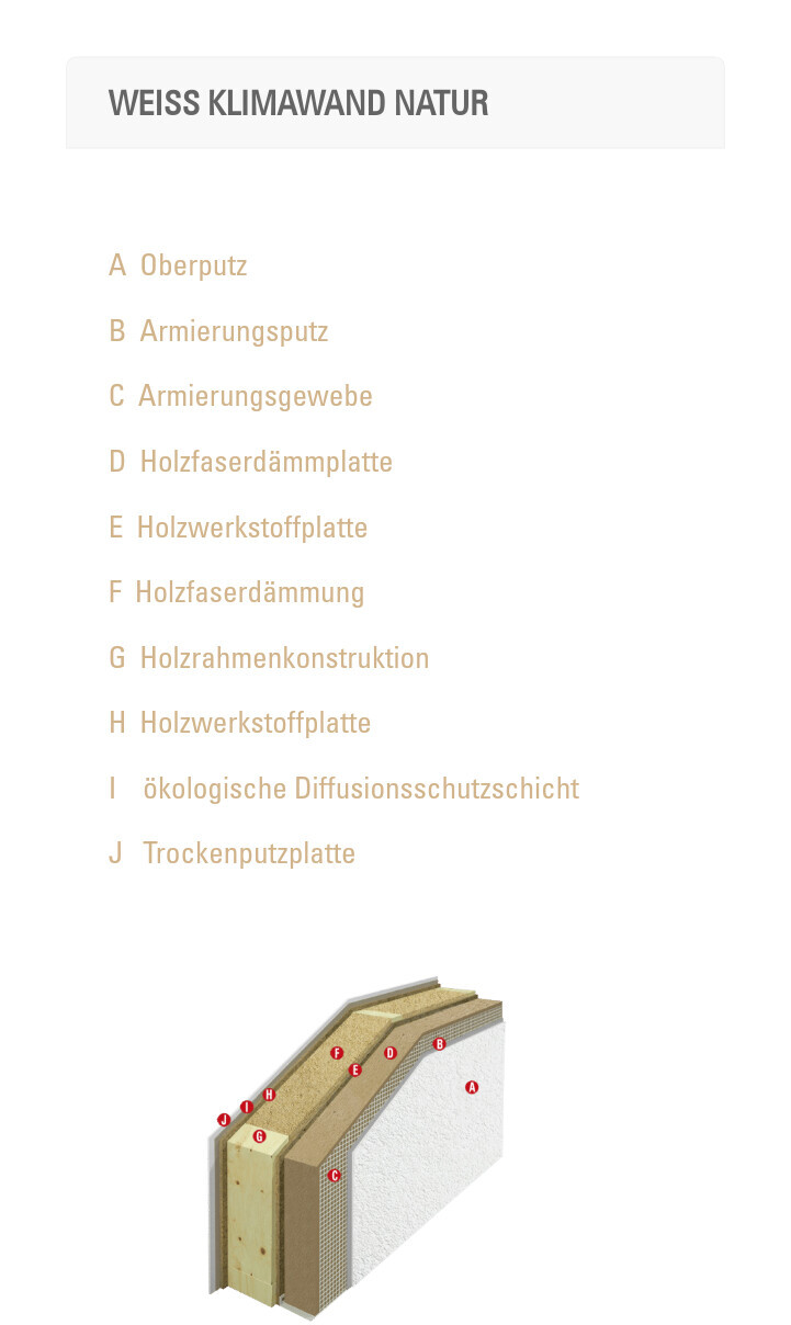

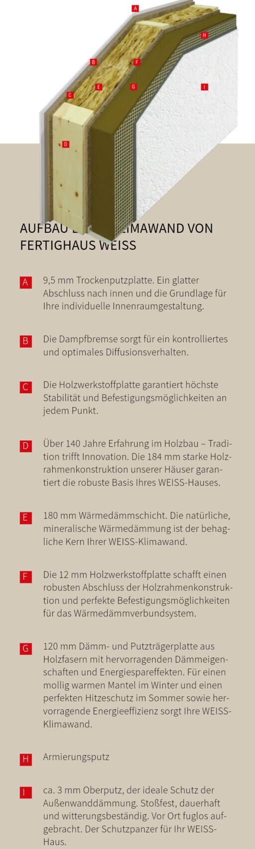

Catibu74Hello dear forum members,
we have planned a prefabricated house with the company Weiss and are currently deciding which wall construction to choose.
The options are the “Klimawand” or the “Klimawand Natur.”
The difference is that in one case a mineral insulation material is used within the timber frame construction, and in the other a wood fiber insulation board.
What advantages and disadvantages would you see?
Healthy living is important to us.
The Klimawand Natur costs an additional 12€ per m² (12€ per square meter).

KarstenausNRW17 Sep 2023 19:40Mineral fiber is less flammable, but wood fiber also burns in a quite controlled manner.
Wood fiber provides better sound insulation and improved protection against summer heat.
Mineral wool requires a lot of energy for production, whereas wood fiber uses renewable raw materials and needs less energy to manufacture.
Wood fiber is considerably more expensive.
The living comfort or the "healthy living" you mentioned is essentially the same with both materials (except for minor details mentioned above). You won’t notice any difference at all. You could also insulate with EPS or build monolithically. It’s all the same, at least when you live inside.
The key difference is already implied in the name. Although wood fiber insulation boards are not entirely "natural," the majority of the material is of natural origin. However, they are treated with fire retardants. This results in lower energy consumption during the production of the insulation material. Mineral fibers, on the other hand, require high temperatures and sometimes high pressure, which leads to a worse environmental footprint. This difference will not affect your daily life inside the house.
Sound insulation is also effective with the traditional construction method; the main focus for improvement there would rather be on windows and connection points.
What matters is that in both cases you have 12 cm (5 inches) of wood fiber on the exterior. Compared to EPS, which could be used as an alternative, this material provides good sound insulation and a high thermal storage capacity. As a result, temperature fluctuations in the exterior plaster during winter and summer are reduced. This leads to fewer cracks in the long term and especially less algae growth. Algae tend to appear after five or more years, once the "pesticides" (which are not allowed on any European farmland but may be undisclosed ingredients in the plaster) have been washed out by rain.

Given the price difference compared to the wood fiber option, I would tend to choose the latter. Spending €2500 (approximately $2700) more on a house build can certainly be wasted less sensibly, and even if the internal insulation no longer contributes much to heat protection, it certainly won’t hurt. Overall, I find it more consistent to use wood fiber in both layers of insulation instead of a half-and-half approach.
WilderSueden schrieb:
I also find it more consistent overall to use wood fiber insulation in both layers, instead of splitting it half and half.At least within one sandwich, I think it’s good to maintain as much monolithic structure as possible. Any successive layering of materials with different thermal conductivities adds complexity and potential risks that are hardly studied. This even applies to the same material, just with different densities.https://www.instagram.com/11antgmxde/
