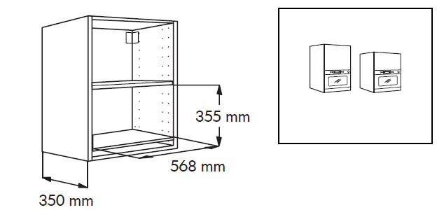

I have mounted two wall cabinets ME 343 (W60 x H40 x D38.8cm (W24 x H16 x D15 inches)) side by side on the wall. The extractor hood Utdrag is installed in the left cabinet, which also has power outlets. In the right cabinet, I want to integrate a microwave. I would like to use the BEJUBLAD in white, but unfortunately, it is too deep! As an alternative, I have now chosen the HUSHÅLLA in stainless steel.
But is that even possible? The dimensions should fit, but the installation instructions only show "taller" cabinets.
Is this a heat dissipation/ventilation issue, or is there another reason against it? Has anyone done this before?

IKEA-Experte25 Feb 2016 20:03For this purpose, the Blum Aventos HL is better suited than the Utrusta flap hinge if it turns out that the flap extending into the room is bothersome or causes too many injuries to people’s heads.
