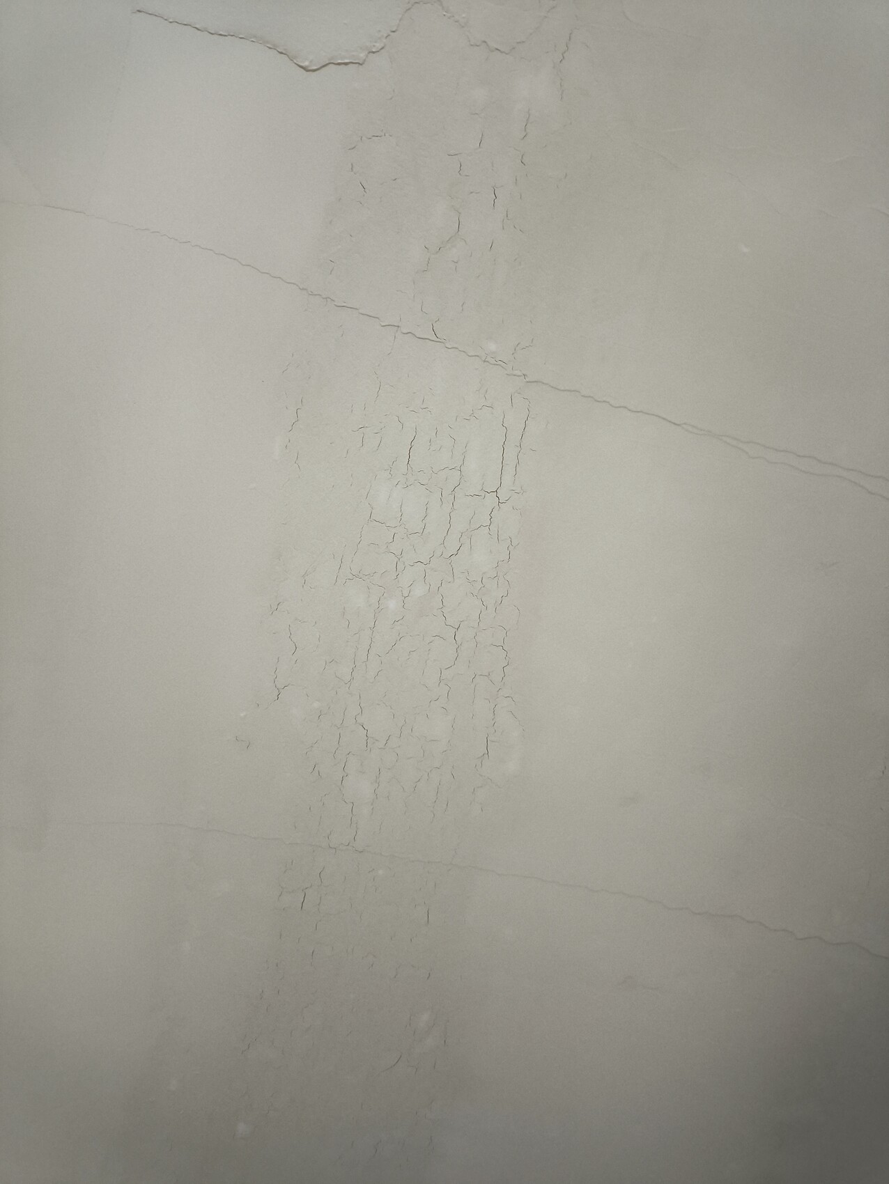

I am renovating a house from the 1970s.
The drywall sheets in the living room ceiling are probably the same age.
I first applied a Q1 finish, then Q2, and have now fully skim-coated with Q3.
I am now noticing micro-cracks appearing in several places.
I used Knauf Uniflott Finish and did not prime beforehand, which had worked well so far.
What did I do wrong, and more importantly, how do I repair this?
Thank you
Wand mit Rissen und abgeblättertem Putz, Hinweis auf Baumangel.
R
Rumbi441
12 Jan 2026 16:00
Prime the surface and apply a new layer. Sanding might also help.
However, it can be assumed that something else is damaged at this spot on the wall if it looks like this…
