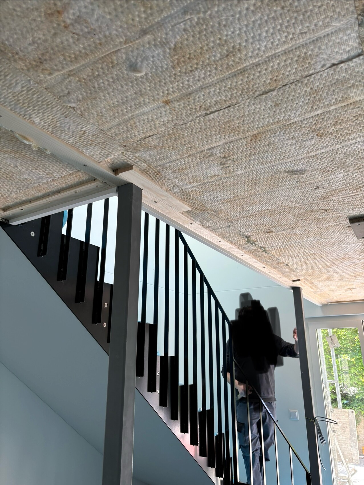

We are in the final stages of our building project. The prominently visible stair railing was just installed. Somehow, I’m not happy with the appearance; the weld seams don’t look very neat. What do you think? Am I being too picky? Or is this normal/good workmanship? What would you do?

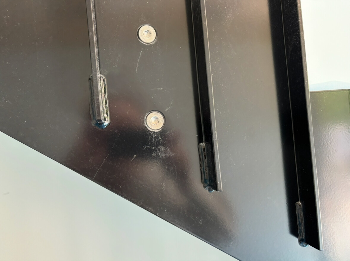

NatureSys20 May 2025 19:37The cutout couldn't have been smaller, right?
Jokes aside, maybe add a larger cutout as well, so it’s easier to assess.

MachsSelbst20 May 2025 21:10It’s a bit discolored, but the weld looks good, right?
What bothers you? That only a small part of the brace was welded and not the entire length? That’s not necessary; it’s strong enough as is.
Heat discoloration is common with welding and can be removed. Pickling, grinding, brushing, sandblasting, coating, etc.

The scratches bother me more. Did the metalworker forget to have his calming drink before tightening the screws?

the weld seams are fine, of course, they could have been polished nicely, but you would have had to arrange that beforehand. However, the scratches and the chipped paint around the screws are not acceptable at all. I hope you did not approve it like this.

NicolettaZ20 May 2025 21:26Thank you, you’ve reassured me a bit! Fortunately, the scratches are just dust, and I will mention the screws.
