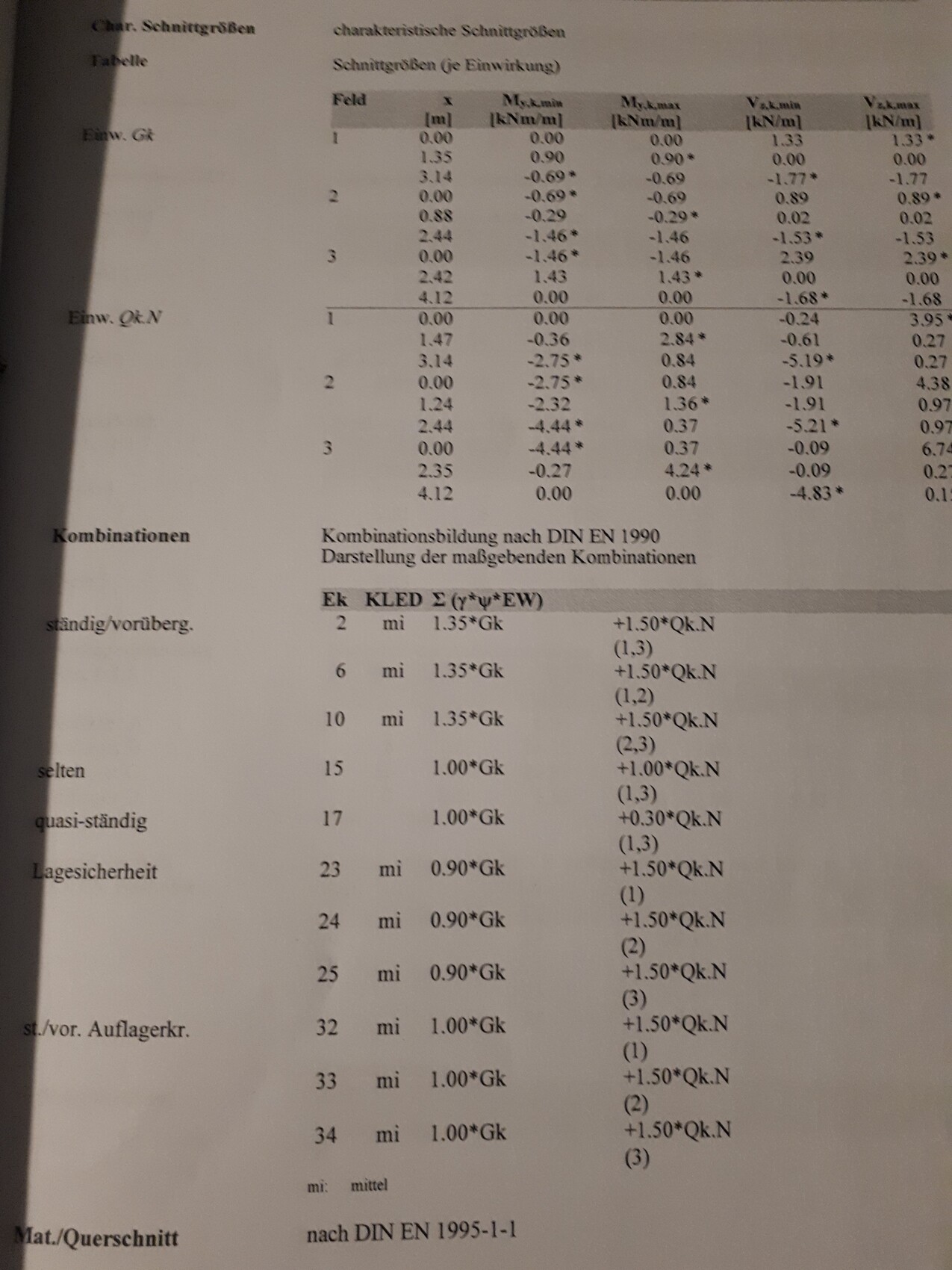

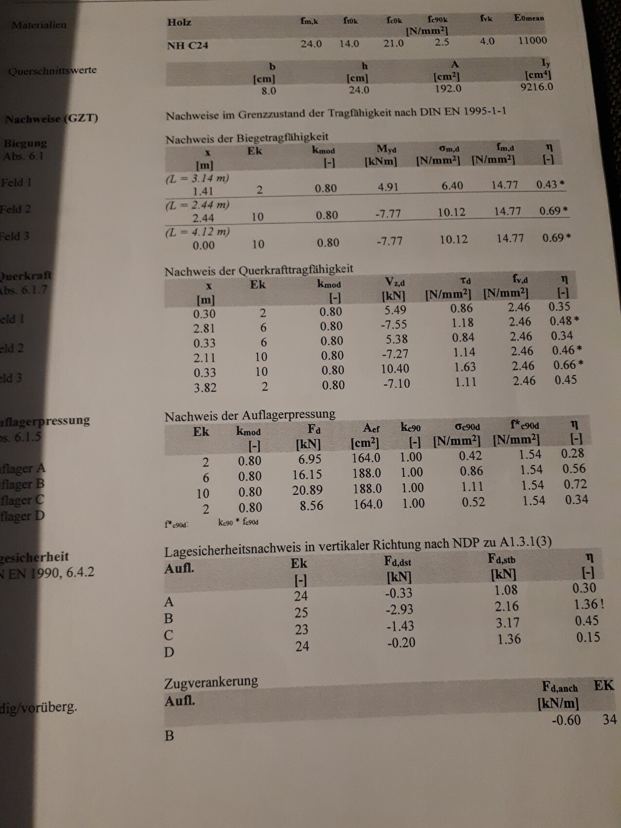

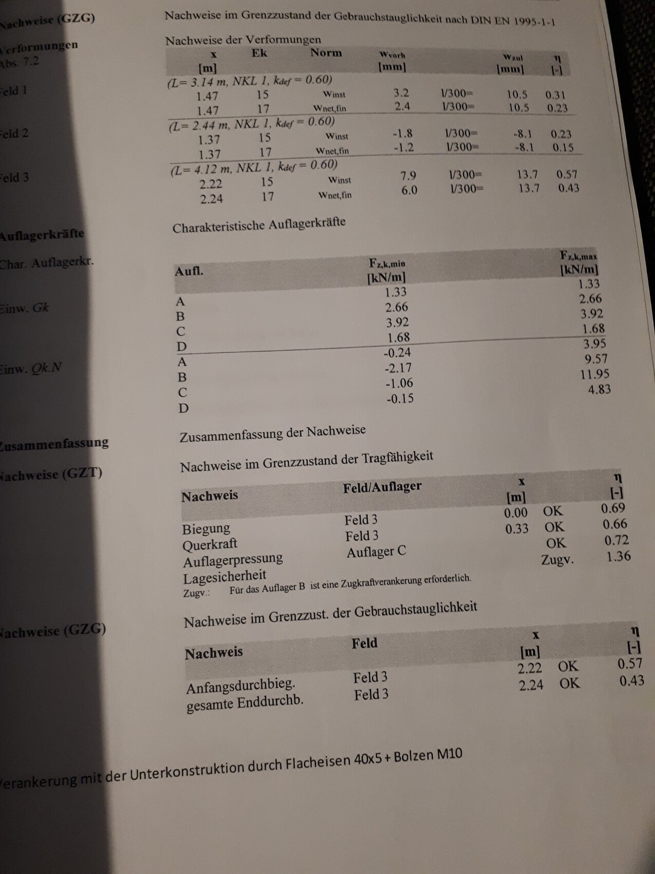

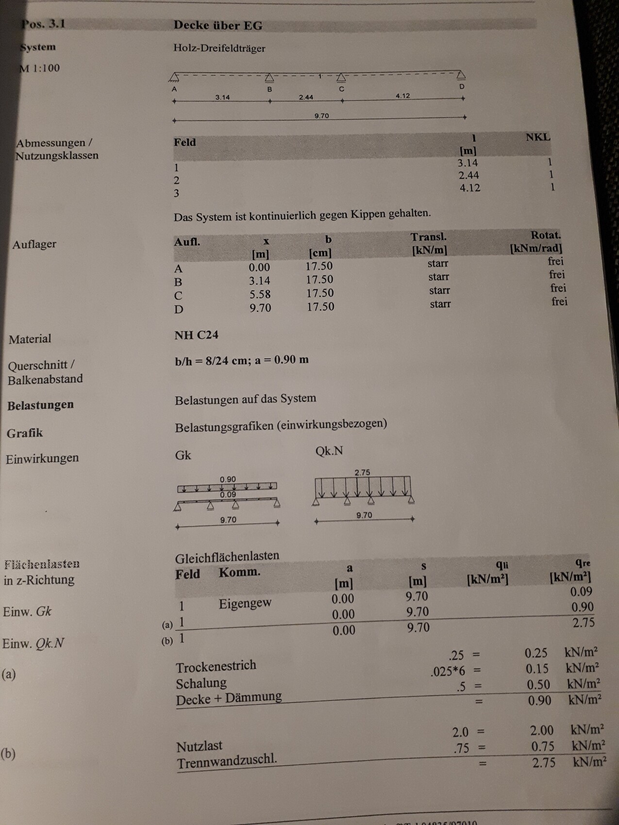

pffreestyler8 Jan 2020 10:40No worries, for the structural calculation of our wooden beam ceiling, we specified that we will use drywall later on. Therefore, we are now committed to using dry screed and cannot use wet screed. From what I have learned, this is not necessarily the best choice, but it’s common practice here if the space is not going to be finished right away. Maybe you can make sense of the data to see if aerated concrete would also be suitable.

pffreestyler8 Jan 2020 14:25@11ant Ultimately, sand-lime brick and aerated concrete (e.g., Ytong) are not really up for consideration. The idea that wet screed wouldn’t work is just my assumption, as only dry screed was planned. To be sure, I would probably need to ask the structural engineer.
