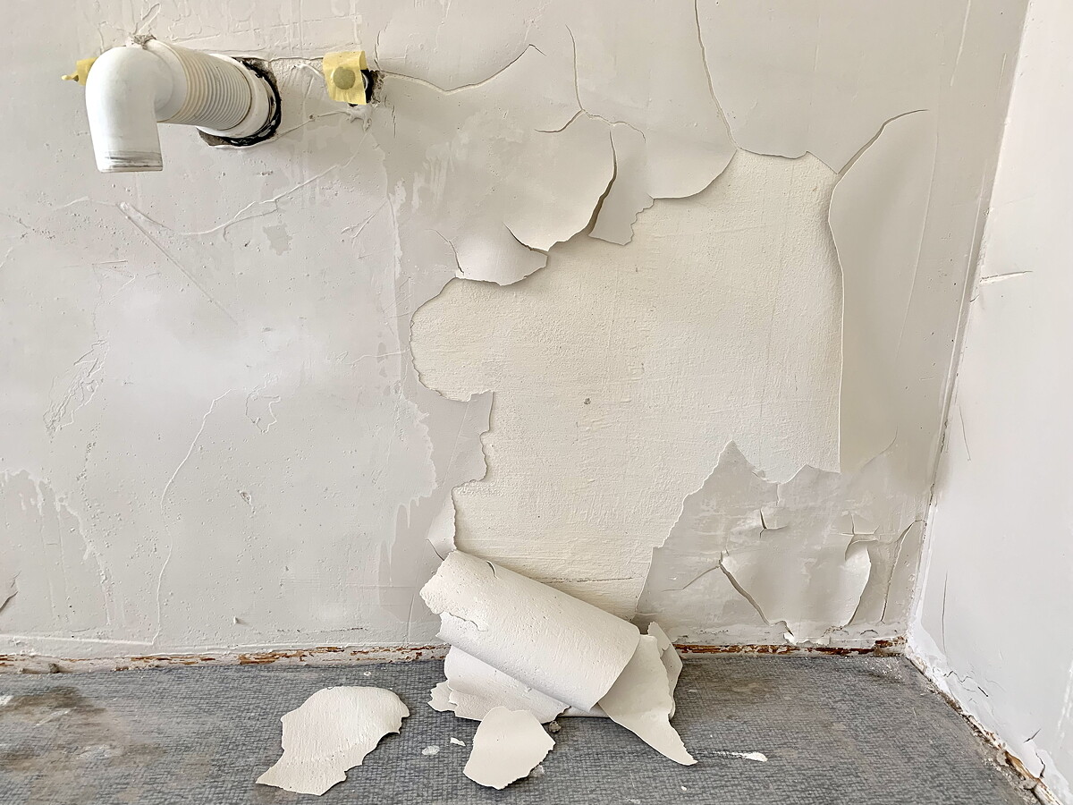

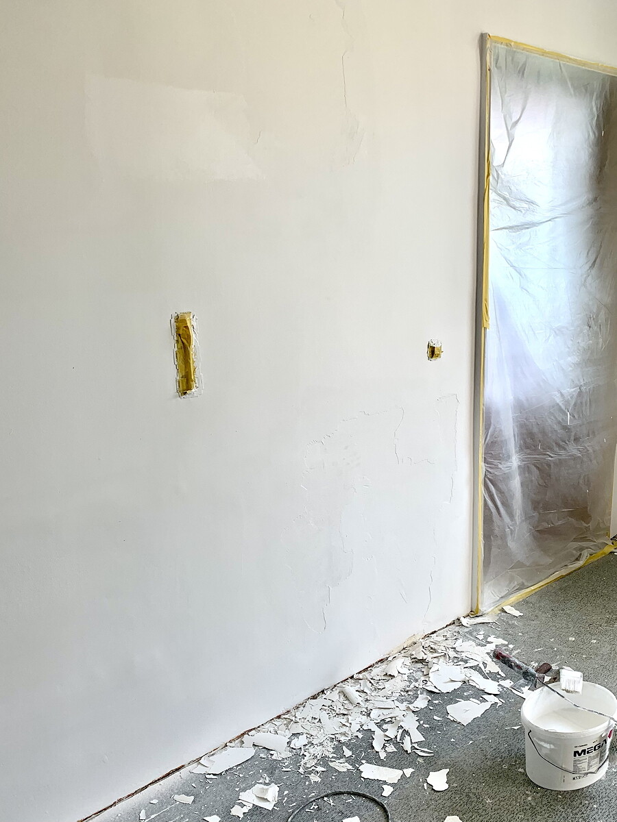

On the very first day of the painting work, carried out by a master craftsman company, the filler started falling off the wall.
The master painter responded quickly by applying a generous amount of primer to the remaining filler, which only cracked further.

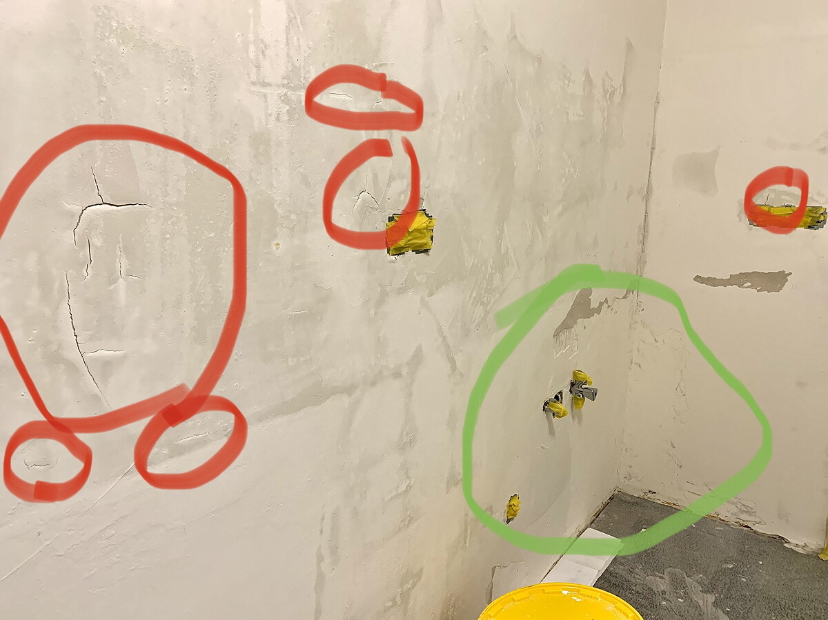

On the third day, the cracked filler was scraped off the wall and re-applied. The painting was scheduled for the next day, so drying was supported using a construction dryer.
On the fourth day, the paint was applied, but on the opposite wall it would not adhere, partly crumbling off or forming bubbles.

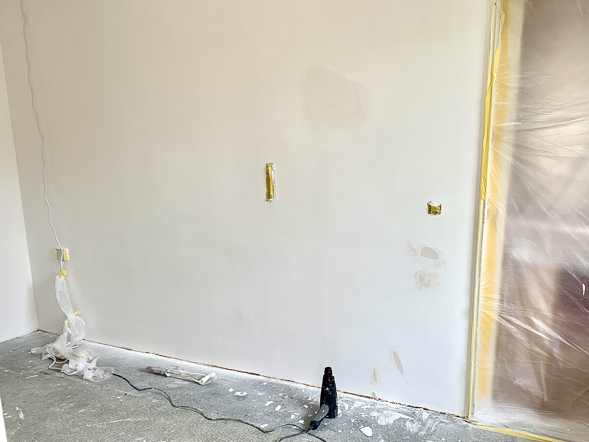

On the fifth day, since his apprentices were already on vacation, the master painter himself stepped in, scraped off the last paint bubbles from the wall, and selectively rebuilt the paint layers. A hairdryer helped speed up the drying process.

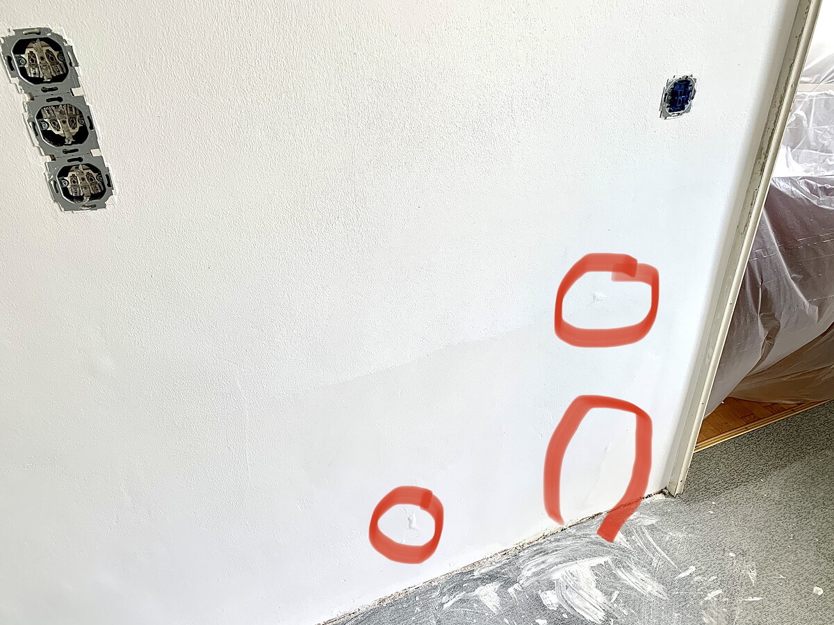

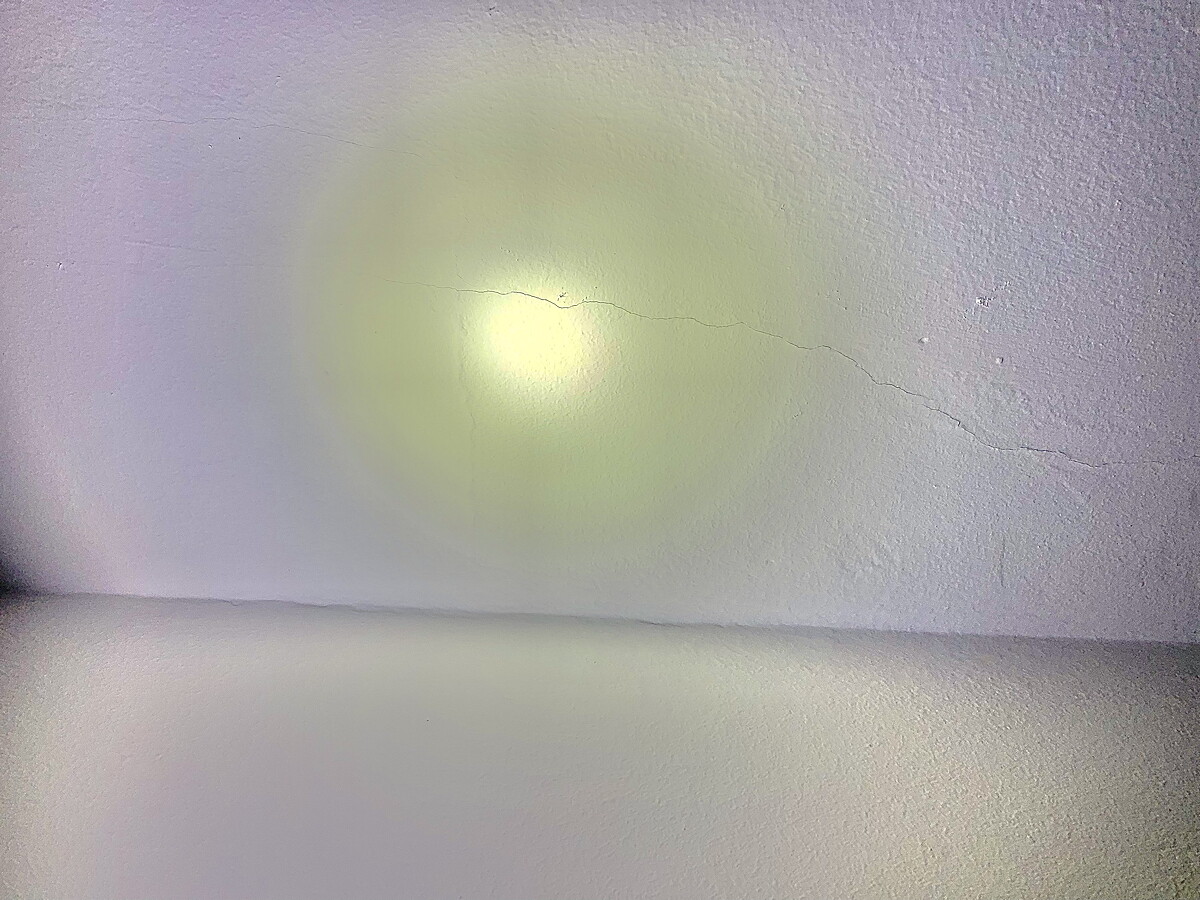

The joy of the now almost finished kitchen (only the glass backsplashes are missing) would help me forget the whole matter if it were not for the small crack in the ceiling—I hope it won’t start to crumble. I am beginning to worry 🙁

If there haven’t been any cracks so far, there won’t be any more.

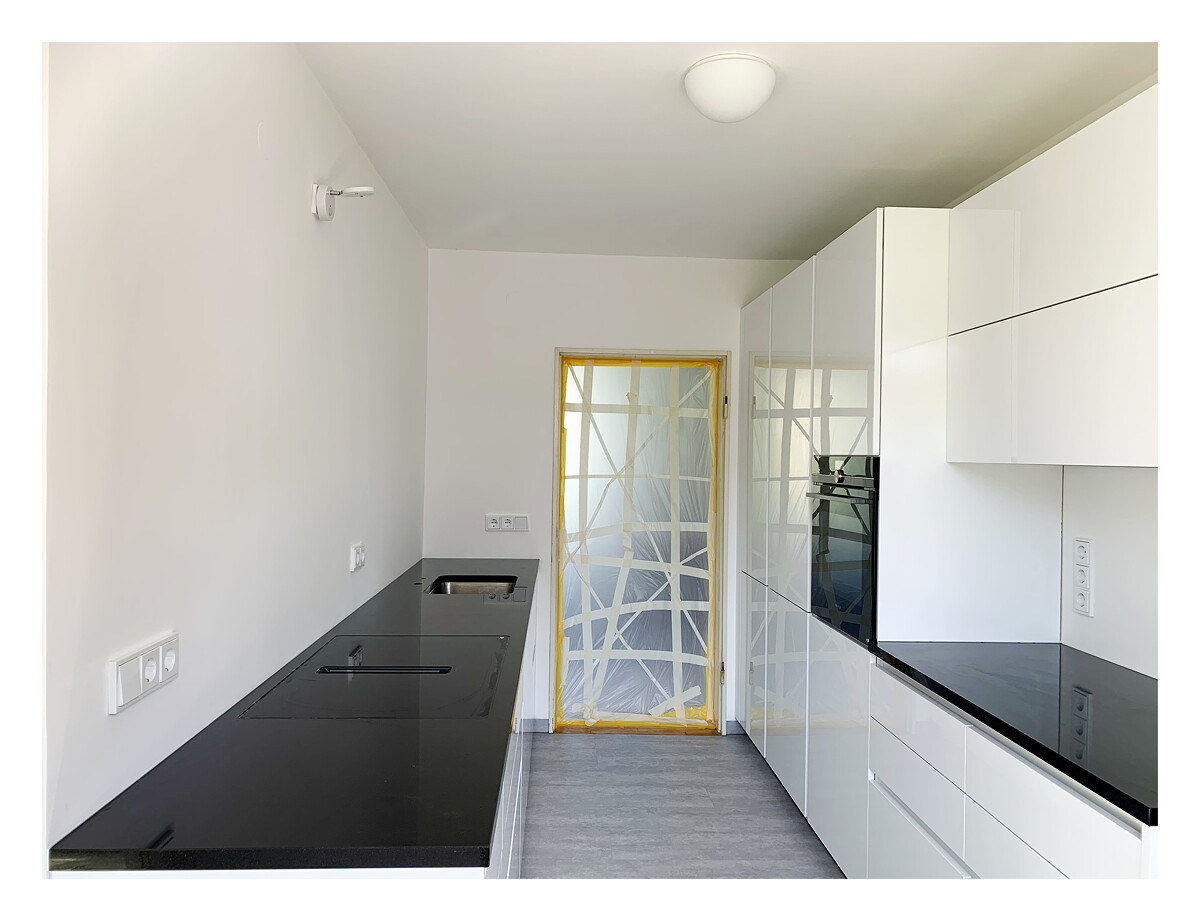

I would rather be concerned about the power outlets next to the sink or the white wall behind the kitchen units. Those outlets are definitely not allowed. It’s not a wet room and they’re too close to water sources.
No splash protection on the wall? How long do you expect that to stay clean? Yep, the kitchen turned out great; the performance and price are spot on. I’ve had good experiences with the kitchen supplier in the past. But that’s not the point here—it’s about the disappointing work from the master painting company.
As mentioned at the beginning, the kitchen is almost finished; the glass backsplash is still to be delivered, and the fittings have already been installed. The photo can be misleading—I’m not worried about the power outlets; what really concerns me is the durability of the wall finish.
Whether it won’t crack anymore... the painting company wanted to refuse the warranty, listed unfinished work on the invoice, and even after a second coat, the paint still doesn’t hold up behind the kitchen units where the moist air from the hob is directed...

The electrical outlets are not allowed at all.Where does it say that? I believe that statement is incorrect.
There is no designated protection zone for washbasins. It may be true that outlets with covers are a better option and provide a greater sense of safety.
