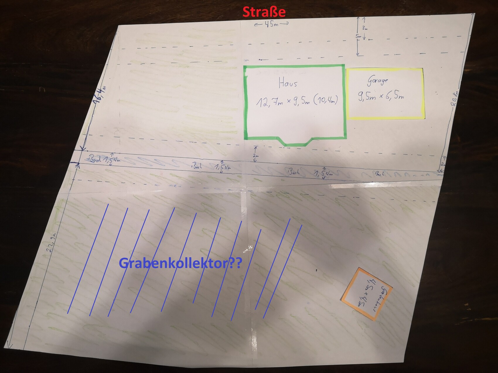

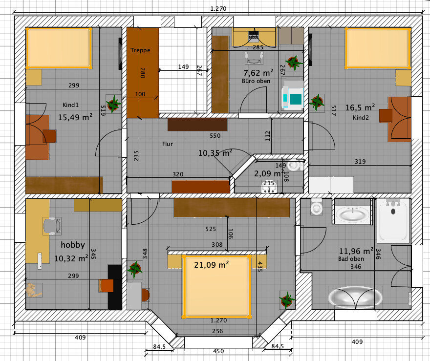

We are currently planning our single-family home and would appreciate some assistance. We already own a plot of land, and I have a few questions about it. I’ve attached some pictures of the property and our plans. The marked stream runs underground in a pipe about 25-30cm (10-12 inches) deep. However, the land slopes down from the street about 90cm (35 inches) toward the middle and will be leveled at street level with fill.

For timber frame construction, I have concerns about sound insulation inside the house (children’s rooms above the living room with home theater). Is good sound insulation between floors achievable in this system?

3. We plan to use a heat pump with geothermal energy. Given the lot size, I considered trench collectors, but I wonder whether they have to be placed directly next to the house or, as in the drawing, can be a bit away from the building? The piping would then connect in the garage approximately.

Here is my consideration regarding the collector. Hello maleba89
I get the impression that you are not writing to ask for advice, but rather to have your plan confirmed.
Steven
No, that is not my intention. I’m asking about the collector to find out if it would actually work the way I imagine. Also because I first need to connect the line to the collector.
I think a trench collector is more advantageous for this property than ground drilling. Since it belongs to the heat pump system, it might also qualify for BAFA funding.

I’m asking about the collector to find out if it actually works the way I imagine it. Hello maleba89
The collector is initially cheaper than drilling. The drilling pays off quickly.
Calculate this: How warm is it one meter (3 feet) underground during a frost? You need to keep in mind that you are extracting heat from the ground for an extended period. After a short time, the compressor will have to run continuously because there’s no more heat coming through. Most likely, the electric heating element will be constantly turning on as well.
Cooling in summer? You can forget about that quickly. At that point, an open refrigerator door would be more effective.
Now, about the drilling: Even if there’s minus 20 degrees Celsius (minus 4 degrees Fahrenheit) outside for weeks, the temperature at depth remains constant. You can’t remove enough heat to deplete it. In summer, it’s always cool down there. For me, at 75 meters (246 feet), it’s always 15°C (59°F).
You save several thousand euros initially. But those savings are quickly offset by higher electricity consumption (compressor, electric heating element).
