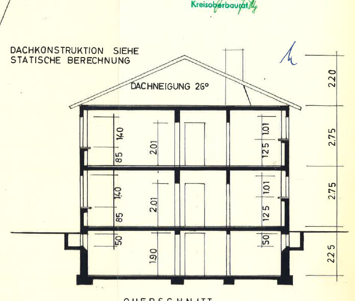

I have owned a house for about three years now (built around 1970) and would like to make a small change in the attic. Here is the situation: The large living room in the attic (which spans the full width of the house) has knee walls (is that the correct term?) set inward so much that there is a large unused space behind them. Presumably, this was done to minimize the sloping ceiling in the room.
I would like to install a 70cm (28 inch) wide door in this side wall, which is about 160cm (63 inch) high, to at least be able to use the space behind it for storage. After a test drill, I found out that the wall is 16cm (6 inch) thick and built with standard hollow concrete blocks. Now I am wondering if this wall might have a load-bearing function and if creating an opening for the door could cause major problems.
Or could it be said that regardless of whether it is load-bearing or not, a 70cm (28 inch) opening would not cause any issues anyway?
The original building plans from the 1960s do not include a floor plan for the attic, only a side elevation, which I am attaching. I have no idea if this helps at all.
What do you think?

Do you mean whether the rafters rest on this wall? It’s hard to tell because either the wall was built up to the rafters or the rafters were laid on top of the masonry wall. I don’t know how to distinguish between these two options.
However, it would be unusual if this wall supports the rafters, since it is not continuous across the entire attic floor. In fact, it only exists in the large living room and is roughly half the length of the attic floor.
In the adjacent rooms, the knee wall is set much further back or is not present at all, allowing the space to be used almost up to the very corner.

Of course, without guarantee, I have no concerns about this. A masonry knee wall certainly wouldn’t serve as a principal purlin. It could provide bracing, but I don’t see your desired small door "affecting" that potential function significantly.
