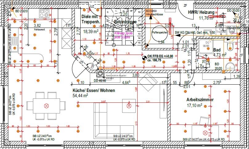

Originally, we planned to install granite flooring throughout the entire ground floor, except for the utility room. Now, however, we have come across a stylish marble floor (Verde Guatemala) at a natural stone supplier. We would like to install this marble throughout the ground floor in various sizes, on the stairs, and in the upstairs hallway. (The upstairs hallway is only 4.5 m² (48 ft²).)
Question: Is polished marble suitable for stairs and kitchen, or is it too slippery? Is the surface hard enough to withstand the wear and tear in the entrance area over time? Can marble be repolished if it becomes worn? How resistant is it to grease or similar substances that might splash from a pan in the kitchen? I have read that marble is not acid-resistant, but spills of vinegar or other acidic foods are probably not very common.

Additionally, there’s the polished surface. You have to like that. Many people don’t like light reflecting directly from the floor. Often, it can look cold—especially combined with many ceiling spotlights*—or outdated when natural wood is part of the interior.
* You have planned a lot of those. Reflections, for example on the stairs, could be distracting!
