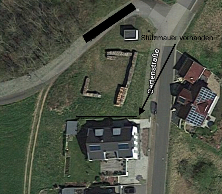

I will try to get a site plan soon and possibly take some photos. It is not exactly a slope. The gradient from north to south is already compensated by the neighbor. (This must be verified structurally and discussed with the neighbor.) The slope from west to east (east street side) still needs to be checked. That is why I want to build with a basement, which would probably need to be constructed with reinforced concrete. This might mean that no retaining wall is necessary.
It is not easy to describe this here. I’ve included a sketch in the picture that might illustrate it a bit better.
As you can also see from the image, the plot is currently a “flat slab” with only a grassy embankment about 2–3 m (6.5–10 feet) high to the east. That is why the timber can still be stored there for now.
The path in the northwest is a rarely used farm track.
For your information: the picture is oriented to north!

This is not a slope location. Everything is within the normal range.
