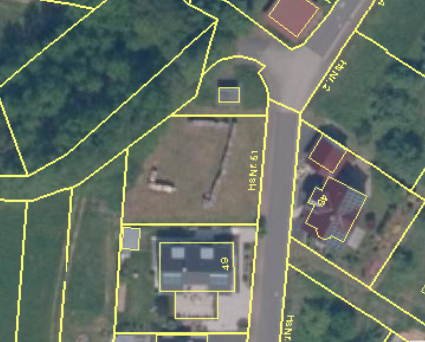

benediktr14 Feb 2019 20:19The house is planned to have approximately 175 m2 (1,884 sq ft) and a projection in the living area of about 5 m by 1.5 m (16 ft by 5 ft). The site is not on a steep slope. The plot slopes from west to east by about 3 m over approximately 25 m (10 ft over 82 ft), and from north to south by about 2 m over 27 m (7 ft over 89 ft). There is already a retaining wall facing south towards the neighbor.
The house is intended to be oriented towards the southwest. The small L-shaped section will also open up in this direction. (To the west, there is forest and meadow.) Currently, I do not have a surveyed plan. However, the land is privately owned and fully serviced. For now, I can only provide a screenshot from the BayernAtlas.
Regarding the development plan: The location is a small town with about 5,000 inhabitants. §34 of the Federal Building Code (Baugesetzbuch) applies. In this district, there are a variety of houses, ranging from gable roofs and shed roofs to log cabins. Therefore, I have no concerns that the intended building style will not fit in.

The plot ... is number 51?
benediktr14 Feb 2019 20:37Sorry, I only saw the first one. However, I followed both and find them both very well done.
Correct No. 51
Correct No. 51
