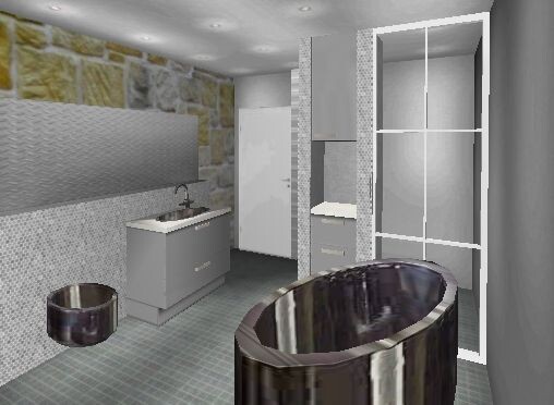

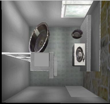

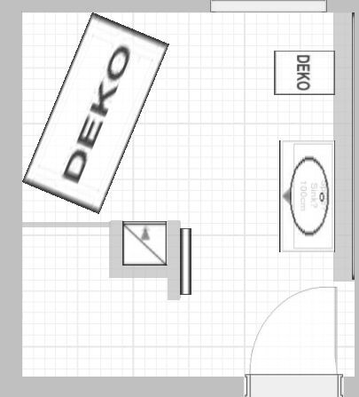

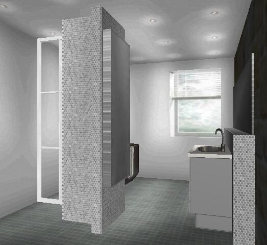

I’m not sure what else could be changed if you really want to. But if it’s going to be a freestanding bathtub, I would plan as follows:
Top-Down Grundriss eines Wohnraums mit Dekorationsgegenständen und Türöffnung
  • Shower in the front left, with drywall walls up to the ceiling forming a recessed shelf niche. The area facing the shower can be tiled with very large-format tiles, which I would also use on the shower walls. Within the drywall, either a stainless steel shelf or an integrated shelf for shampoo and similar items.
  • In this example, a glass partition about 80 cm wide (31.5 inches) towards the top of the layout. The entrance to the shower on the right is approximately 70 cm wide (27.5 inches). On this drywall, a towel radiator with a low profile, preferably with exposed bars facing downward in the plan.
  • Washbasin remains 1 m wide (39.4 inches), positioned in front of a maximum 20 cm deep (7.9 inches) and about 110 cm high (43.3 inches) half wall.
  • Toilet placed next to the washbasin.
  • A wide mirror above the half wall.
  • The bathtub set slightly angled into the niche. When seated with the head towards the bottom of the plan, you can look out the window.
Tried to recreate this in Alno Planner.
Top-Down-Ansicht eines kleinen 3D-Badezimmers mit Waschmaschine, Waschbecken und Dusche
Modernes Badezimmer mit freistehender Badewanne, Waschbecken und Glas-Schiebetür.
Kleine, graue 3D-Küche: Spüle rechts, Fenster hinten, mosaikverkleidete Trennwand.

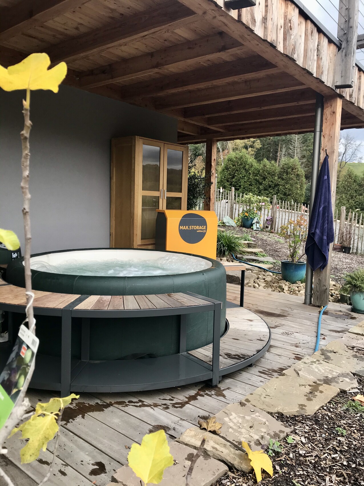

Having a garden setup like that can work wonderfully depending on the property—possibly including a bathhouse the size of a garden shed. We opted out of a bathtub, instead having a very spacious shower in the bathroom and a covered Softub on the upper terrace in the garden. No neighbors can see it, and we enjoy the view.

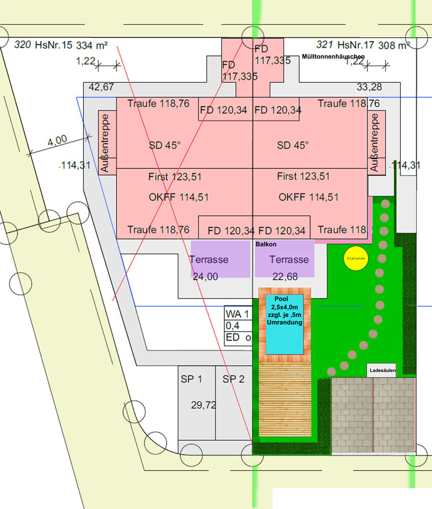

Well, unfortunately the garden space will be very limited. There is a picture of it in my "kitchen thread." Here it is again... But the garden design is not yet finalized...
Floor plan of a residential building with terraces, balcony, pool, and surrounding garden.
The pool is being built for medical reasons as well as for enjoyment, of course.
