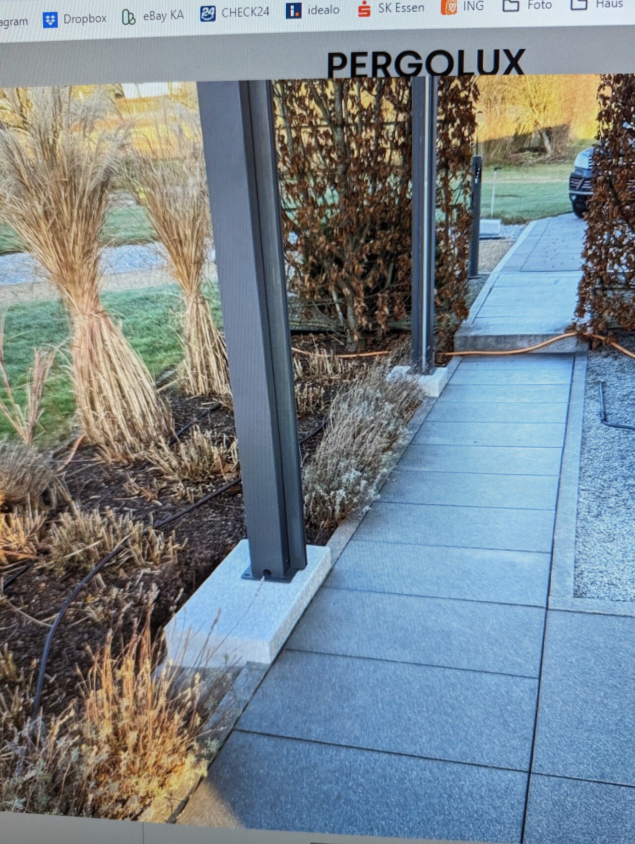

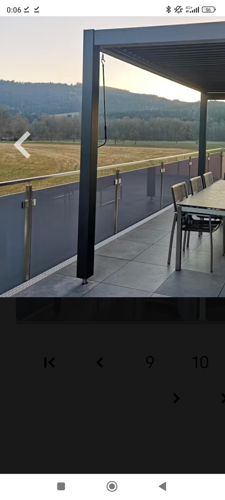

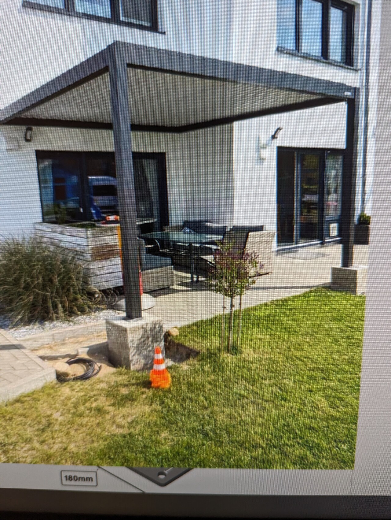

We have ordered a Pergolux pergola with wall mounting. One side will be attached to the house’s masonry, and the other side will be supported by two posts.
The pergola has a height of 235cm (7 ft 8.5 in) at the underside. However, I need to raise it to at least 250cm (8 ft 2.5 in), so I have to build a roughly 15cm (6 in) high base for each post. Both bases also need to be exactly the same height.
The base will be built on the existing terrace, which already has partial foundations in the relevant areas. However, I am still looking for the right method.
1) Place prefabricated concrete bases (such as stair blocks or similar) on the old foundation? Will that hold?
2) Create isolated pad foundations on the existing foundation? What should I pay attention to?
I imagine it roughly like in the pictures, just a bit lower... the last picture shows the spot on our terrace where the base should be built.
