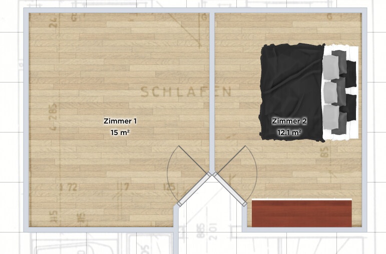

This would be the most space-saving option
Two-room floor plan: room 1 empty on the left, room 2 with bed on the right.

And number 2, my "idea," without "any 3-dimensional pattern drawings without a detailed floor plan." These should only help answer the question "Where should the furniture go?" Bed 2 x 2 meters (6.5 x 6.5 feet), the rest will be newly purchased and custom-made by a carpenter. The idea: A closet in the hallway would, for example, hold towels and bed linen, accessible to all family members.
2D floor plan of a bedroom with loggia, blue marked sketch
Do you manage to place furniture in the rooms with this version?
Personally, I wouldn’t plan any slanted doors either; that’s really no longer modern.
I would arrange the door to the bedroom in a way that a wardrobe fits right behind it. Or possibly make the wall between the rooms “S-shaped” so that offset niches for wardrobes are created in each room.
Friends of mine use built-in wardrobes instead of a wall to separate rooms. It works well for them, although you might need to consider soundproofing again.
