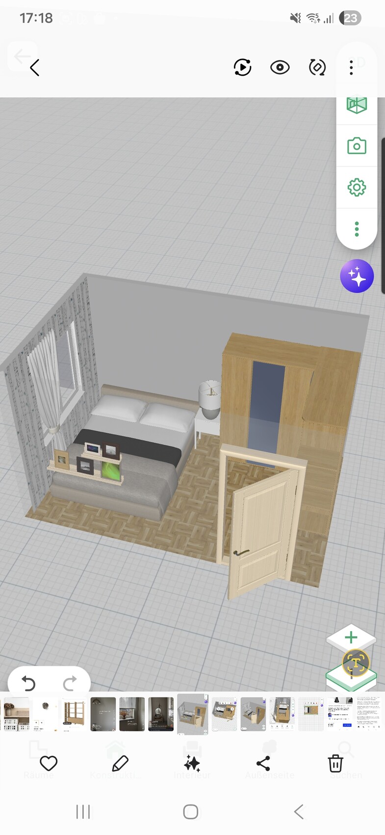

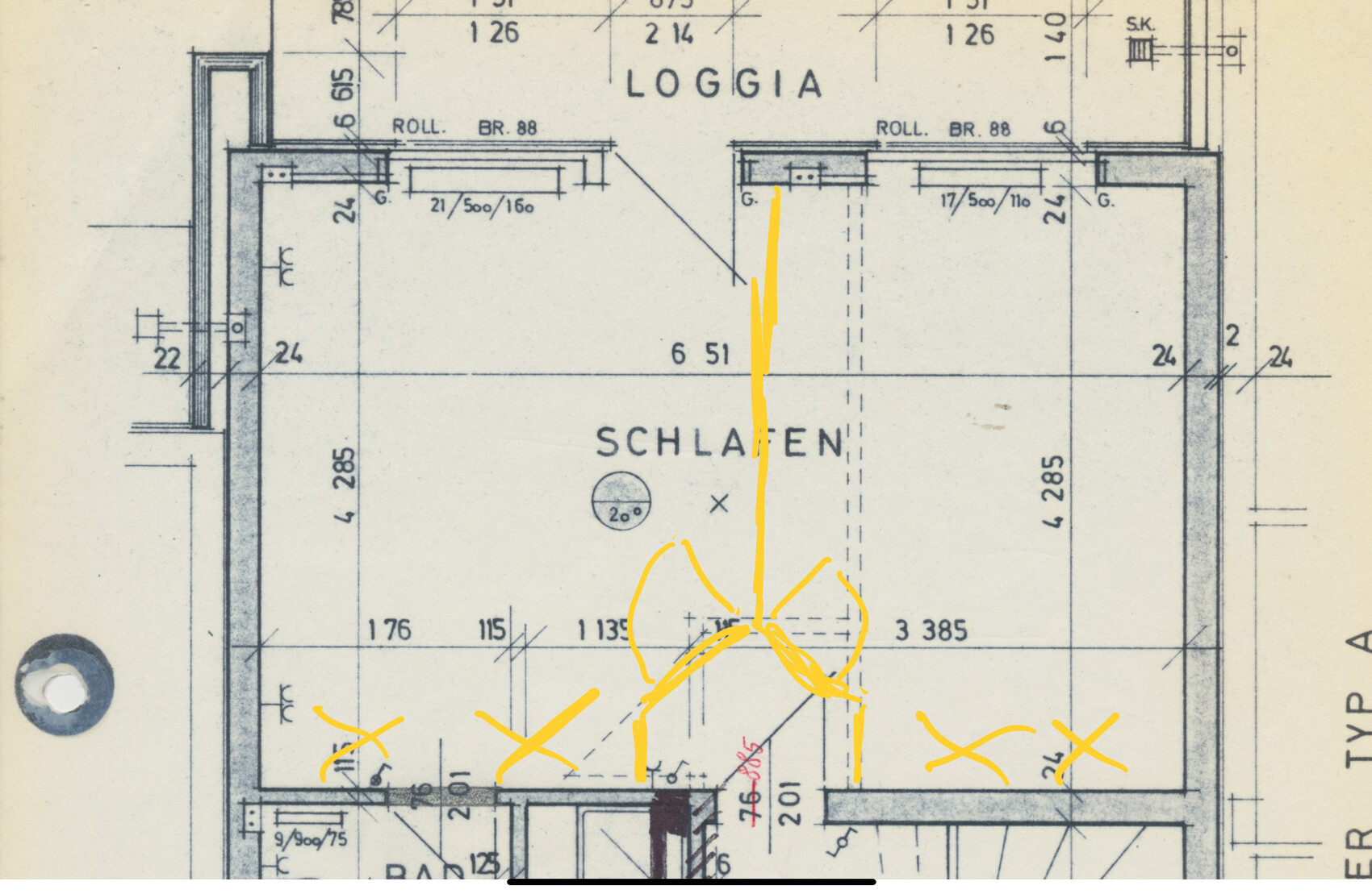

This is the original floor plan, showing where the new hallway is planned to be created (dashed line as a concept on the floor plan) along with the rooms, as illustrated in the pictures. However, there might be better ideas!

... and please don’t post random 3D renderings without a dimensioned floor plan as a demonstration of whatever. Sometimes all you can do is shake your head. 🙄

Otherwise, I assume this door is not important and would separate the rooms like this:
Layout plan of a bedroom with loggia and yellow sketch markings

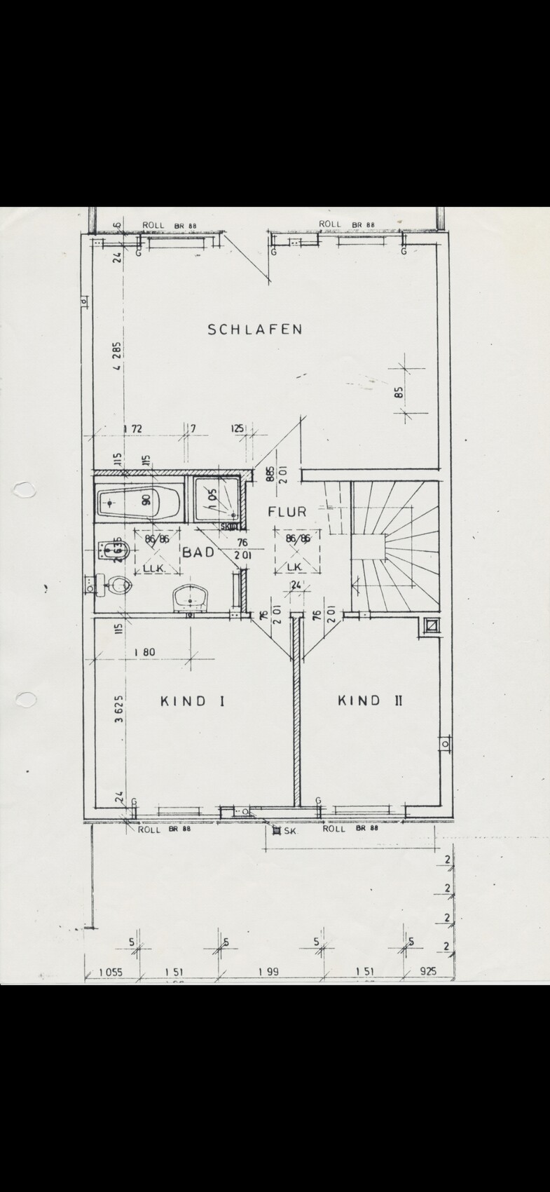

This is the floor plan of the level – however, I don’t understand how this relates to or is needed for my question @kbt09 ...

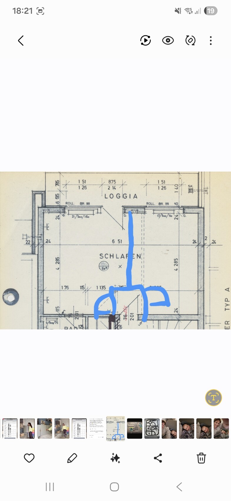

And number 2, my "idea," without any "3-dimensional pattern pictures without a dimensioned floor plan." These should only help answer the question "Where should which furniture be placed." Bed 2 x 2 meters (6.6 x 6.6 feet), the rest will be newly purchased and custom-made by a carpenter. The idea: A wardrobe in the hallway would, for example, store towels and bed linen, accessible to all family members.
