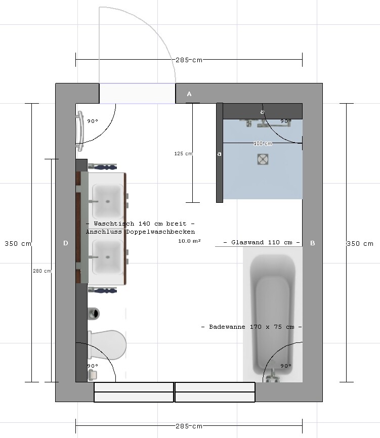

Hi!
We would really appreciate some quick ideas, as we can only present a new proposal later this week.
Unfortunately, we only noticed quite late that the developer planned a relatively short glass partition for the open shower (about 85cm (33 inches)). Now we’re a bit worried about frequent water splashes throughout half of the bathroom.
The bathroom is only 10 m² (108 sq ft) in size, measuring 2.85 x 3.55 m (9.4 x 11.6 ft). As shown in the sketch, we have two windows, which don’t exactly make the planning easier. The bathtub will be 180 x 80 cm (71 x 31 inches) and the vanity with double sinks will be 120–140 cm (47–55 inches) wide.
I already looked it up and found references to these so-called “T-walls.” However, I can’t find any practical ideas on how they could be planned in this case.
Do you have any suggestions, or is the concern about the shower partition unnecessary?
Best regards & thanks for your help!
Gatho

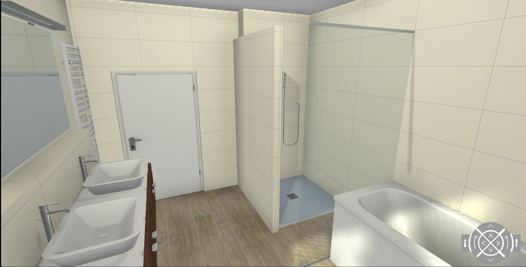

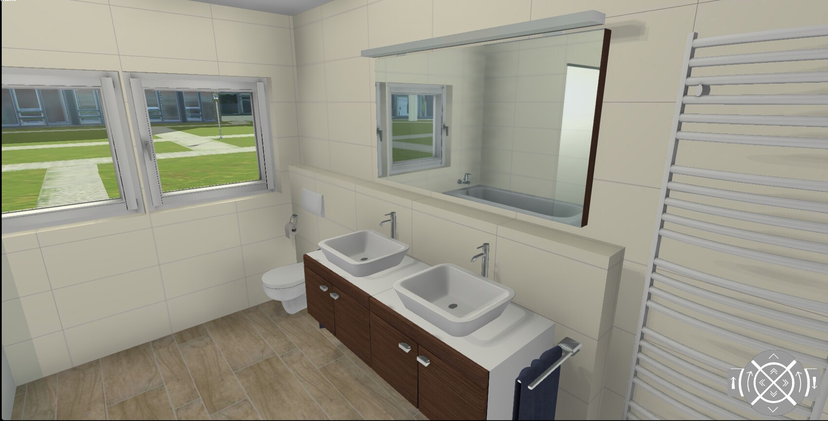

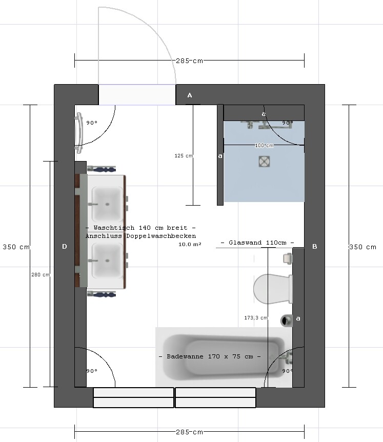

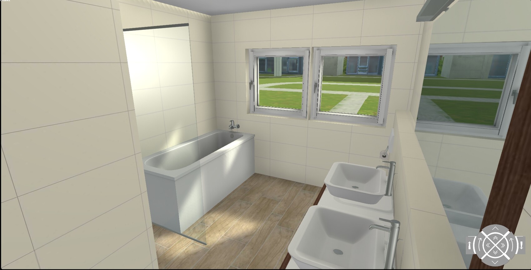

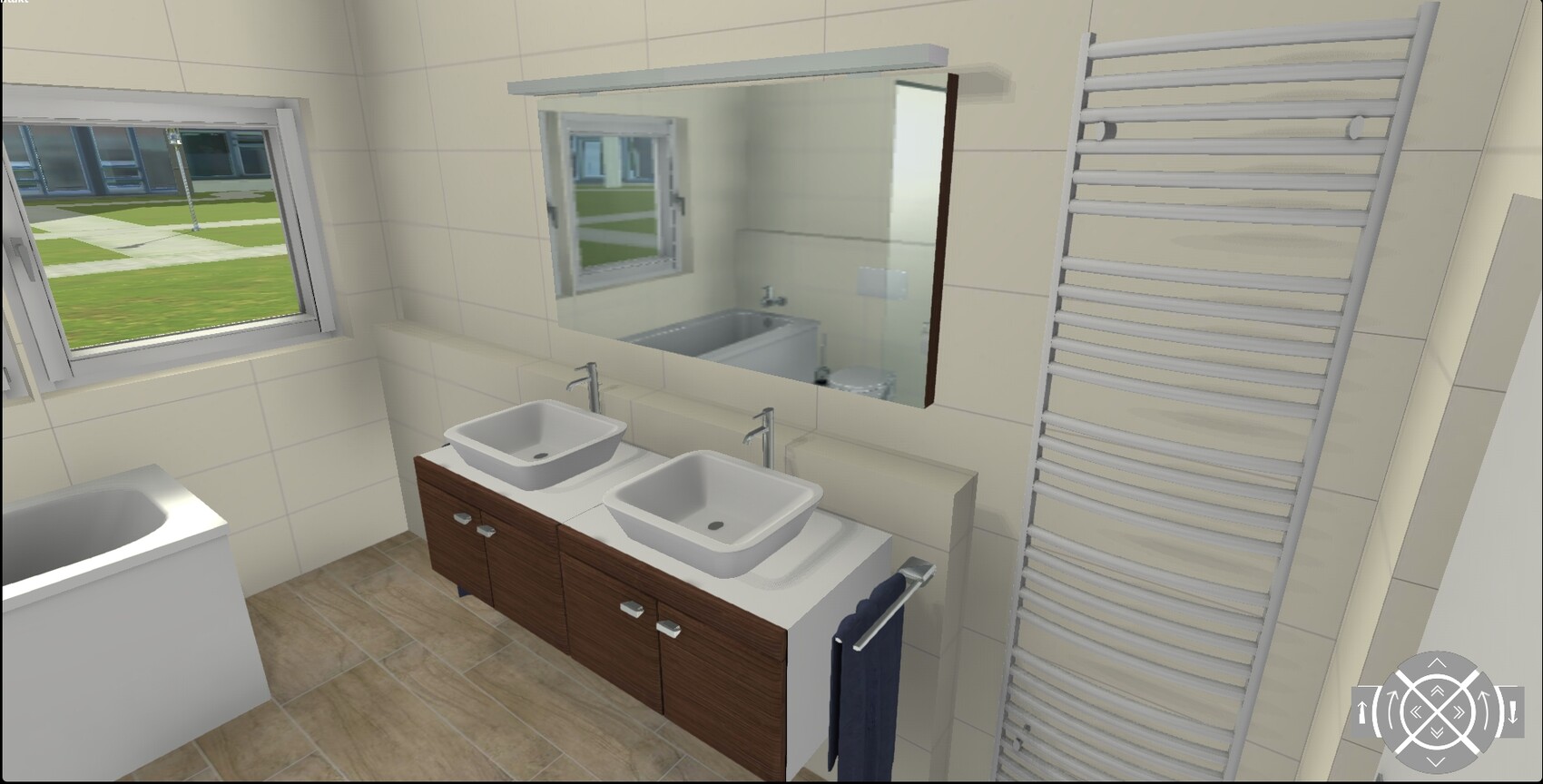

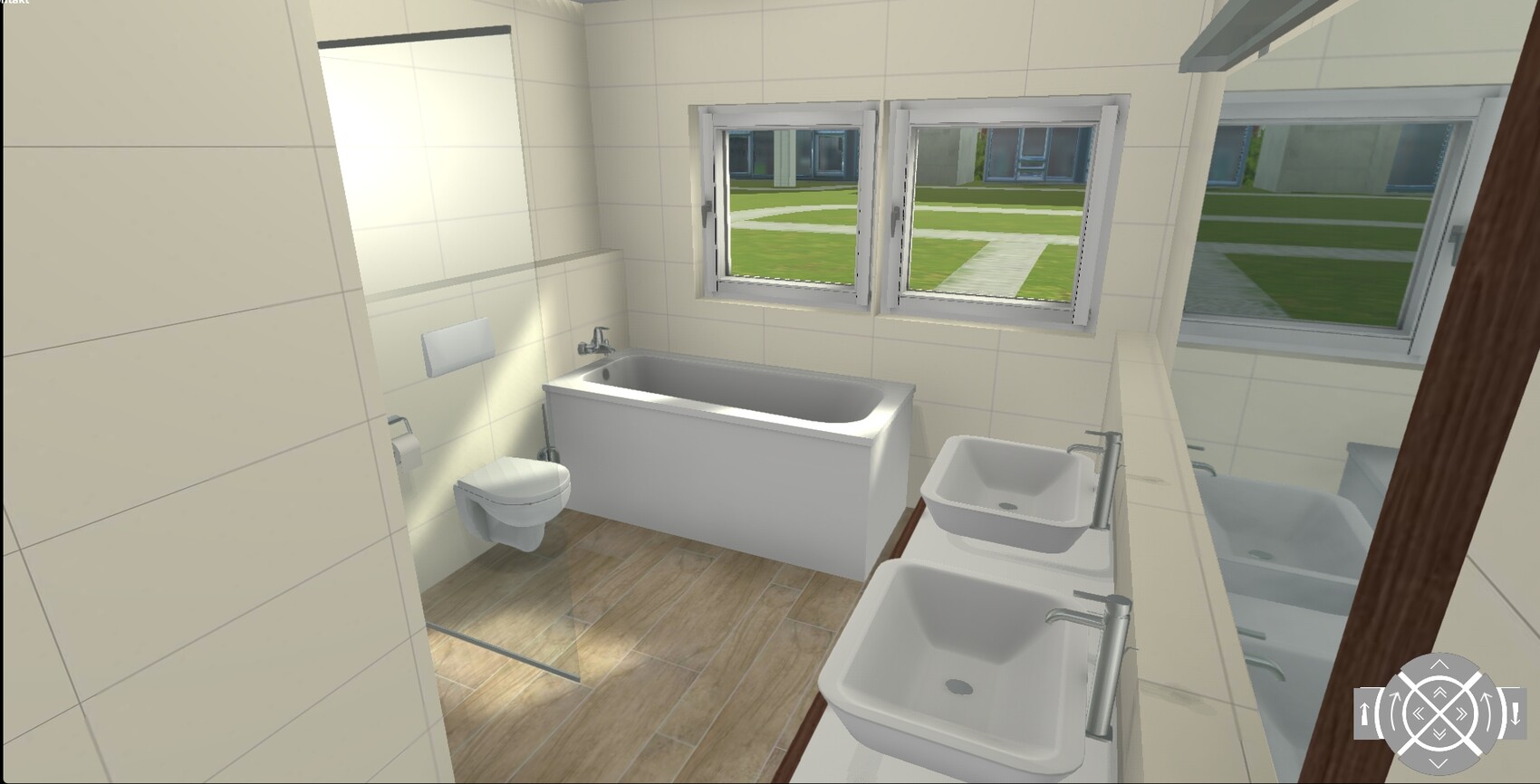

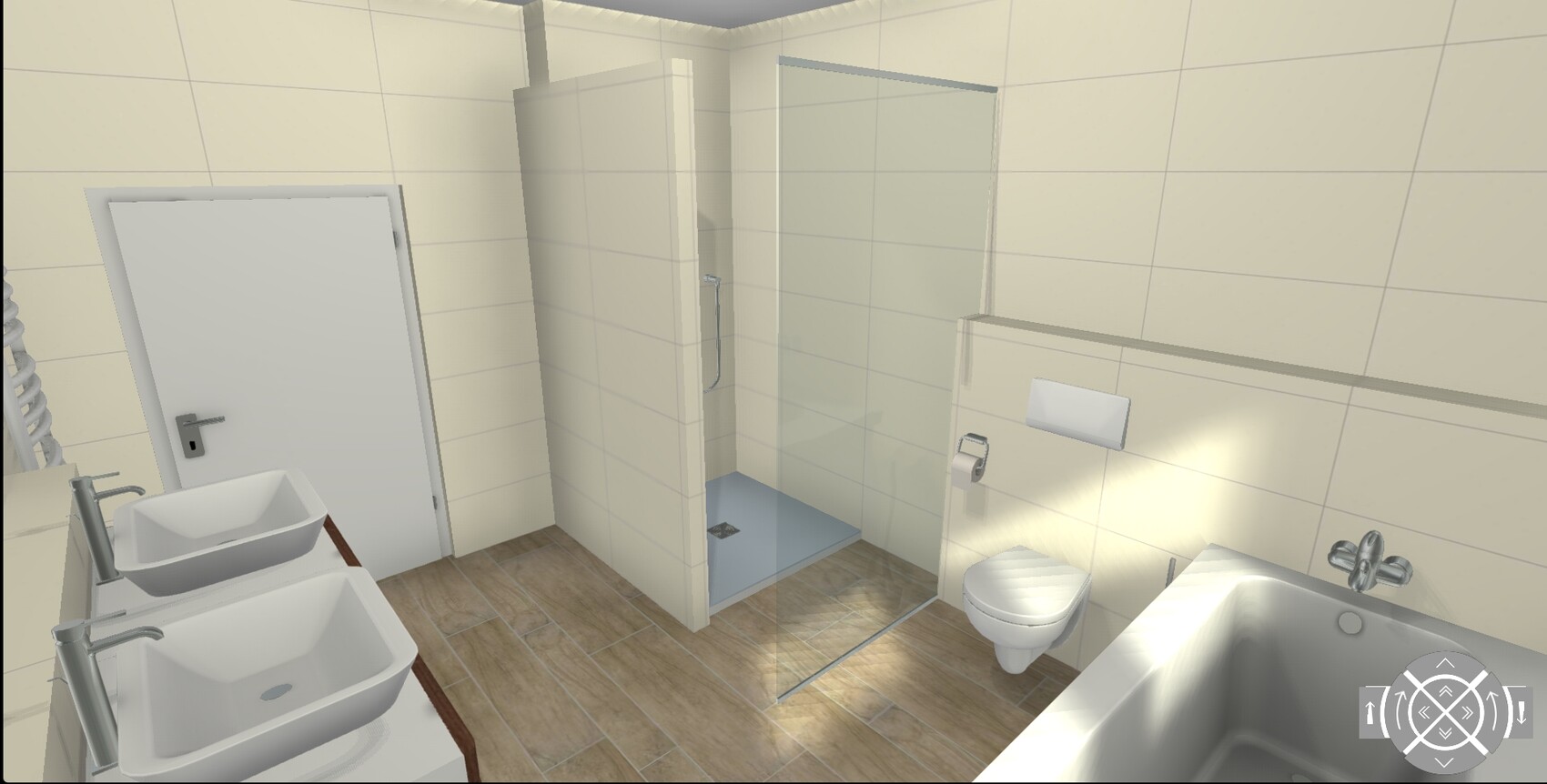

Hi!
Unfortunately, Jochen’s preferred option is too expensive through our builder due to the corner bathtub. So once again, we would appreciate your feedback on the following proposals:
Good luck & many thanks!
Gatho
Bathroom floor plan: Bathtub at the bottom, double washbasin on the left, toilet on the right, glass shower on the right.
Modern bathroom with double washbasin, mirror, window, bathtub, and towel radiator.
Bathroom with double washbasin, shower, toilet, and bathtub in light tiles.
Modern bathroom scene with bathtub, toilet, two washbasins, glass shower, and garden view.
Bathroom floor plan with double washbasin on the left, bathtub on the right, shower top right.
Modern bathroom with two washbasins, large mirror, toilet, and towel radiator.
Modern 3D bathroom scene with double washbasin, shower, and bathtub.
Bright bathroom with bathtub on the left, two washbasins on the right, and window with garden view.
Jochen10411 Jul 2016 07:56
Unfortunately, neither option will work well because your passage into the shower is just under 50cm (20 inches) wide. It will feel very cramped, and if you are ever unwell (using walking aids) or even slightly overweight, it will become impossible.
Gatho
11 Jul 2016 08:11
We based our measurements on the size of the opening currently in our apartment. There, we have a shower with two sliding panels. When fully open, the opening measures 45cm (18 inches). In the two proposed options, it is 51cm (20 inches) in option 1 and 55cm (22 inches) in option 2.
Is it really that tight? Otherwise, we are running out of ideas. As mentioned, a corner bathtub is too expensive and also too small (lying area – I am 1.89m (6'2") tall).
Good luck
Gatho
Jochen10411 Jul 2016 08:18
Gatho schrieb:
We based the size on the current opening in our apartment. There, we have a shower with two sliding panels. When fully open, the opening is 45cm (18 inches). In the two proposed options, the openings are 51cm (20 inches) in option 1 and 55cm (22 inches) in option 2.
I wouldn’t start with a clear passage width under 60cm (24 inches). You also have to consider that you are probably working with rough opening measurements here. On each side, tiling will add another 1.5 to 2cm (0.6 to 0.8 inches) for wall construction (tile adhesive and tiles). That narrows things down even more.
Besides, you want to allow yourselves some comfort in the house and not just rely on your previous situation, right?
Gatho schrieb:
Is it really that tight? Otherwise, we’re running out of ideas. The corner bathtub is, as said, too expensive and also too small (lying area – I am 1.89m (6 ft 2 in) tall).
In the two options you mentioned, you only used a 1.70m (5 ft 7 in) bathtub anyway.
Gatho
11 Jul 2016 08:28
Thank you for your effort!
You are right about what you mentioned... but how else? As you can see, even with a new build, we are willing to make compromises (1.70 x 0.75m (5 ft 7 in x 2 ft 6 in) bathtub... we originally wanted 1.80 x 0.8m (5 ft 11 in x 2 ft 7 in)), but it just doesn’t fit.
Good luck
Gatho
Jochen10411 Jul 2016 08:32
How about option 1 with the toilet next to the shower on the lower wall of the plan? This way, you could save the cost of a drywall construction on one side.
