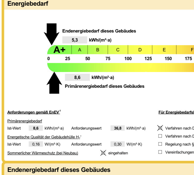

KfW 40+, so not yet a passive house.
I took the value from the energy calculation.
Energy efficiency diagram: building final and primary energy demand, scale A+ to F.

Thanks to the heating load calculation tool, I finally have a basis to work from, even if it’s not 100% accurate. Now, the heating technician shared his calculation basis with me after I sent him mine, and as it turns out, he used different parameters. Let’s wait and see how his new calculation turns out using my values. But it will probably be similar to mine. With the heat pump mentioned above, we will manage without any problems.

Ht 0.16 is really very good. As far as I know, it is better (and probably somewhat more expensive) than what is required for the standard. I also don’t see that you will be cold.
