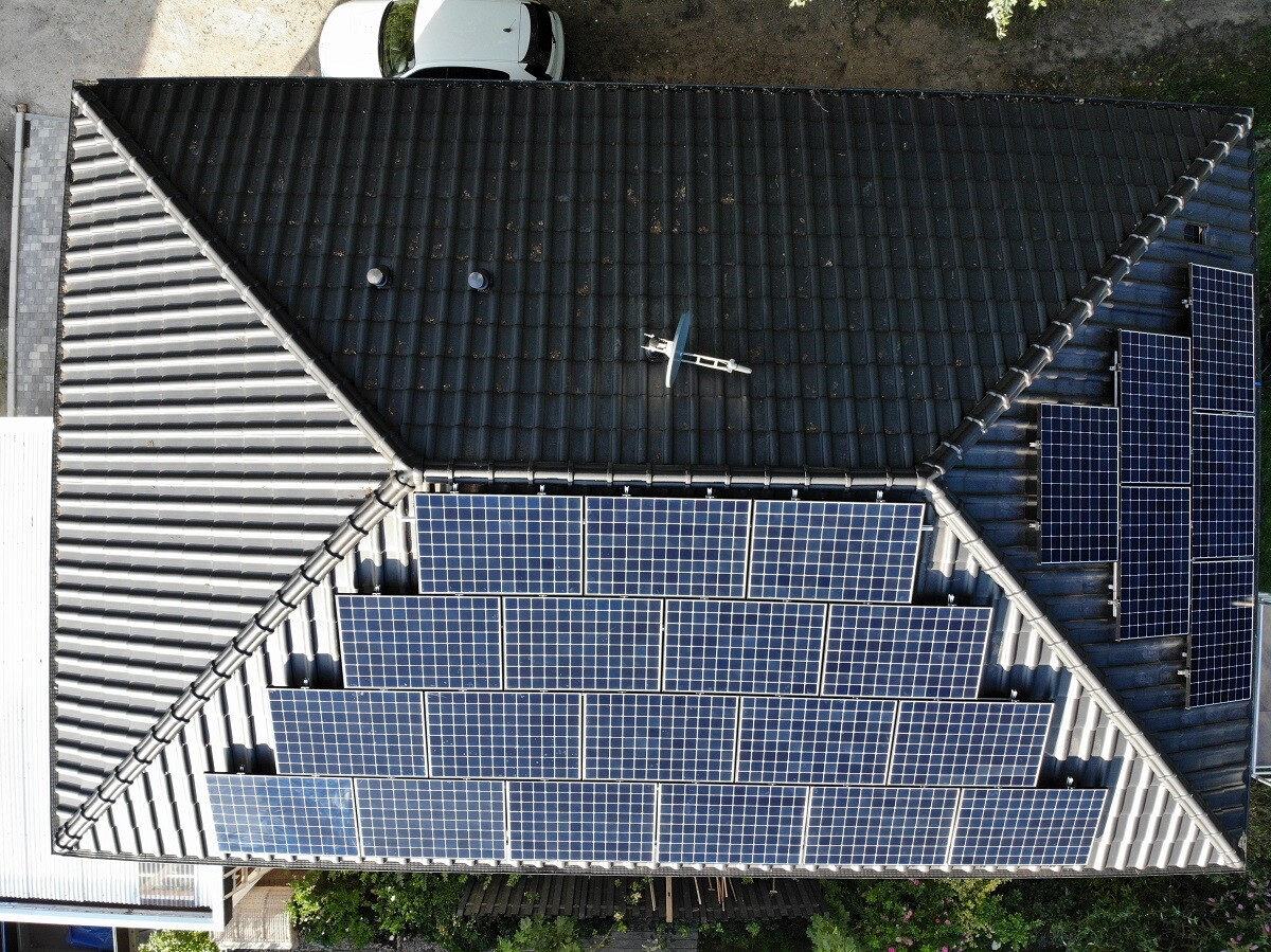

Are you asking me? We have a hip roof, where a triangular section (see avatar) faces south with a slight east lean. There are 6 modules installed there. On the west side (which is logically tilted slightly toward the south), there are 18 modules. The east side could have fit 18 modules as well, but that area was completely shaded because of large oak trees standing there (they were cut down the following year :rolleyes). The north side only allowed for 6 modules, which wasn’t worthwhile in terms of yield.

seth048729 Oct 2020 13:11
@Golfi90 I can't give you an exact answer, but here are some pictures of the installation:
