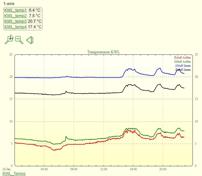

Hi!
I would also recommend measuring the temperatures.
I have a heat recovery ventilation system running, and here are the values I recorded...
Exhaust air inside: 20.7°C (69.3°F)
Supply air inside: 17.4°C (63.3°F)
with an outside temperature of 6.4°C (43.5°F)
Attached is the temperature profile over the course of the day.
