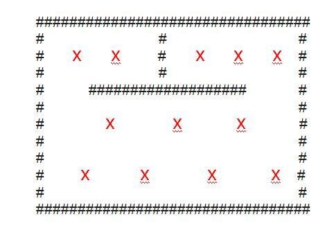

For me, it’s the bathroom, 3.20m * 4m (10.5 ft * 13 ft), with a T-shaped layout for the shower and toilet.
I hope the formatting doesn’t get messed up. This is how I imagined the arrangement (# is the wall, X the spots):
# X X # X X X #
# X X X #
# X X X X #
Are LEDs enough there, or would halogen lights with 35W each be better? That would be 12 * 35 = 420 watts for 12 m² (130 ft²).
# X X # X X X #
# X X X #
# X X X X #

CharlieBrown21 Mar 2013 14:37Renovierer2013 schrieb:
Thanks for the reply!
Are LEDs sufficient, or would halogen bulbs with 35W each be better? That would be 12 * 35 = 420 watts for 12 m² (129 sq ft).
[/FONT]420 watts for a bathroom? The energy provider would be happy about that...
R
Renovierer201321 Mar 2013 15:35CharlieBrown schrieb:
420 watts for a bathroom? The energy provider must be happy...Why don’t you suggest an alternative?
What I definitely hate is when the bathroom is just dimly lit.
And as I said, if I knew what to do, I wouldn’t be asking for advice here in the forum.
My question was also related to whether LED bulbs would be suitable.
