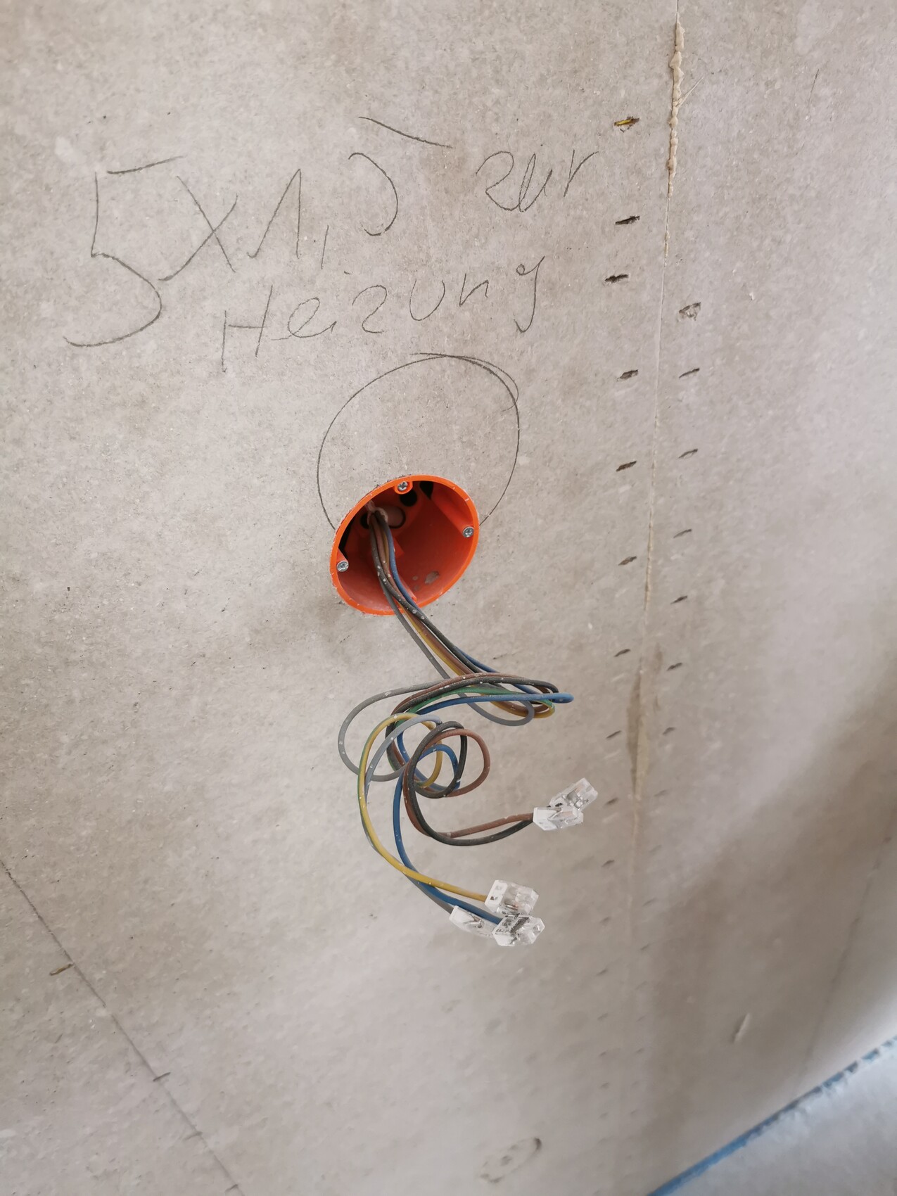

Our black stove requires a negative pressure monitor for the chimney, which is needed because of the air-to-air heat pump heating system. The chimney sweep wrote the following to me: I don’t have a specific negative pressure monitor in mind. What’s important is that the exhaust fan automatically switches off when a negative pressure of 4 pascals is reached.
We have already planned a connection to the chimney. See the attached picture.
Now my question is, which one do I need.
The system is a Proxon from Zimmermann.
Our electrician can install it, but I am supposed to purchase the monitor.
Thanks in advance and best regards
Zenjamino

I assume you mean the models from Huber. Which one do I need to choose then? There is one for flush mounting and one for surface mounting. Also, with or without plug-in sensor? Sorry for all the questions, but I’m a chemist and quite far from these topics 🙂 !

nordanney7 Apr 2021 16:51Zenjamino schrieb:
There is one for concealed installation and one for surface mounting.You need to know how it will be installed. The functions are the same.Otherwise, ask your chimney sweep which one they prefer to use.
