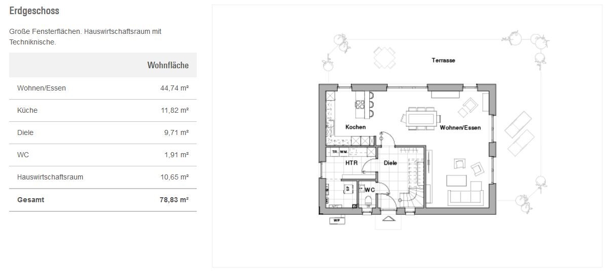

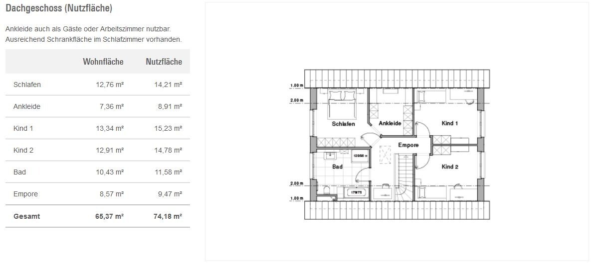

Hello everyone!
We are looking for a suitable floor plan for our hopefully soon-to-be new home.
We visited several show home parks, and the Maxime 300 by Viebrockhaus really caught our attention.
I have attached the relevant floor plans for you.
We really like the layout a lot! We were immediately enthusiastic.
The only change we would want is to mirror the entire upper floor. In other words, we would like the main bathroom and master bedroom to be located above the kitchen and dining area.
This change is because of the beautiful view we would have then. We would be overlooking an open field and the scenic Wiehen Hills.
What do you think overall about the floor plan, and is it even possible to mirror the upper floor considering plumbing and other technical installations?
Do you have any specific suggestions for improvements?
I would really appreciate some opinions and ideas.
Best regards!

kaho674 schrieb:
Otherwise, the upper floor has to be redone, since the staircase can’t just be moved to the side. Basically yes, but here it isn’t so far off center that it would be a major undertaking. The drainage reconfiguration (or its aesthetic integration) is likely the bigger effort.
chrisw81 schrieb:
I also really like the floor plans from Viebrockhaus! If you want a guest room on the ground floor, take a look at the 330. If you don’t find your ideal standard floor plan with Viebrockhaus, Gussek Haus offers a very similar style.
However, I recommend anyone who thinks that a simple mirror image and/or size adjustment would make a standard floor plan perfect to get a competing offer from a locally based builder.
There was a time when people, with few exceptions, could only choose between a Trabant and a Wartburg. Today, many people want to choose only between a Flair and a Jette — go figure...
We will not be building with Viebrockhaus. We will look for a local general contractor and have our architect design the house. Initially, it was just about getting a live image of a floor plan to help us visualize everything better.
In theory, I would give our architect the plans of the house and say, "Go ahead, this is how it should be and this is what we imagine."
Golfi90 schrieb:
Theoretically, I would give our architect the house plans and say, "Go ahead, this is what we want it to be like, this is our vision"... In practice, I believe this is the best approach. Even when working with a local builder, it’s always best to have your own architect. The plot of land also has its say, and in the end, it all comes together.
Golfi90 schrieb:
There are no children. And it is uncertain whether one or two children "are supposed to" come at all...I know the house from the inside through several neighbors – it has been built multiple times in our area.
The couple, who have no children, already realized that the two rooms upstairs are unnecessary; instead, they would prefer to have a room downstairs...
Golfi90 schrieb:
The view from the children’s rooms wouldn’t be bad at all! Please don’t misunderstand. The house would be completely detached with no immediate neighbors.And why have a fantastic view in the bedroom? It would make more sense upstairs in the guest room/office (if not kids’ rooms, or future kids’ rooms), where you can enjoy it during the day.
