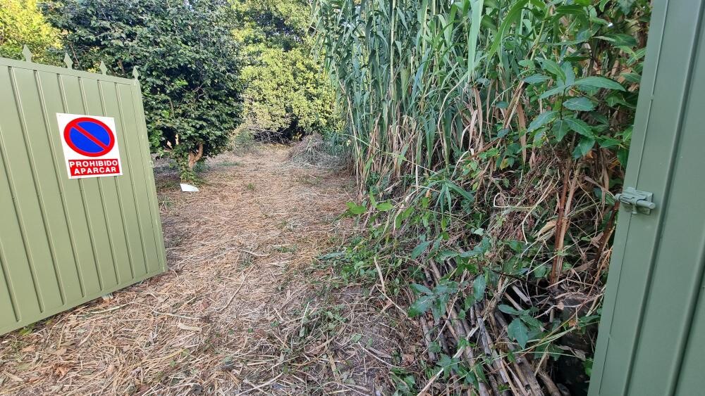

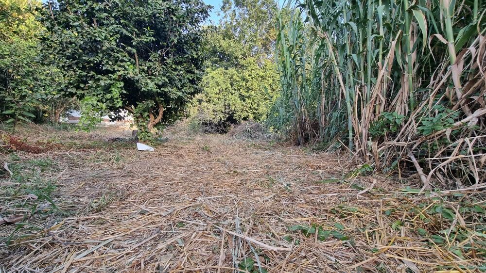

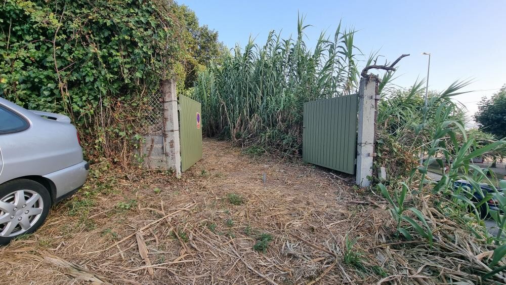

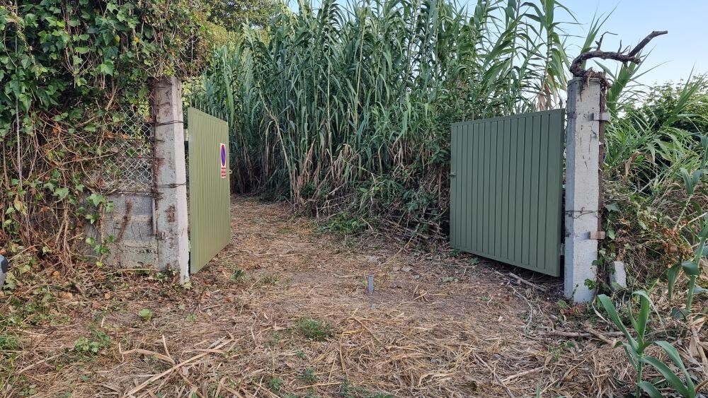

we own a piece of land and would like to simplify the entrance area, including the driveway, so that we can park at least 1–2 vehicles. The gate has already been installed – now only the ground surface is missing.
My question: What simple options are there?

- Concrete – I would prefer to avoid this since the terrain is slightly sloping and we still aren’t sure how we want to design it later. Regarding the almost 1000m2 (10,764 sq ft), I also need to figure out the best way to level this slope.
- Paving slabs
- Tiles
Perhaps you have some useful ideas for us. I will take a few photos and post them here soon...
Thank you
Hi,
with a sloping site and uncertainty about the final design, you should keep effort and flexibility in mind. Cementing limits you permanently and only makes sense if no further adjustments are planned later. Concrete slabs offer more flexibility and can be moved or adjusted if necessary. However, it is important to ensure a solid base layer despite the slope so that the slabs do not sink. Grass pavers or gravel turf are another practical option, especially if you want to maintain infiltration capacity.
wiltshire11 Aug 2025 14:45Crushing gravel, lightly binding it and compacting it layer by layer creates a solid subbase. This method performs well on slopes of up to 10%, provides sufficient resistance against plant root pressure, and remains easy to remove if the terrain needs to be reshaped.
