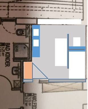

We are currently planning a new build and are a bit stuck when it comes to designing our future bathroom. We have already created or had some plans made, but none of them have really convinced us so far. Do you have any ideas?
For a rough orientation: The bathroom should include a larger washbasin, a toilet, a shower (preferably built-in or half-built), a bathtub, and ideally some space for a small shelf.
Thanks in advance!
Detaillierter Grundriss eines Badezimmers mit Sanitäranlagen und Türen.

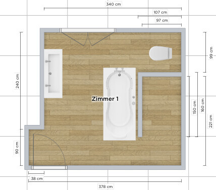

Or like this: it also works without the T. Well?
6 Jun 2021 12:31

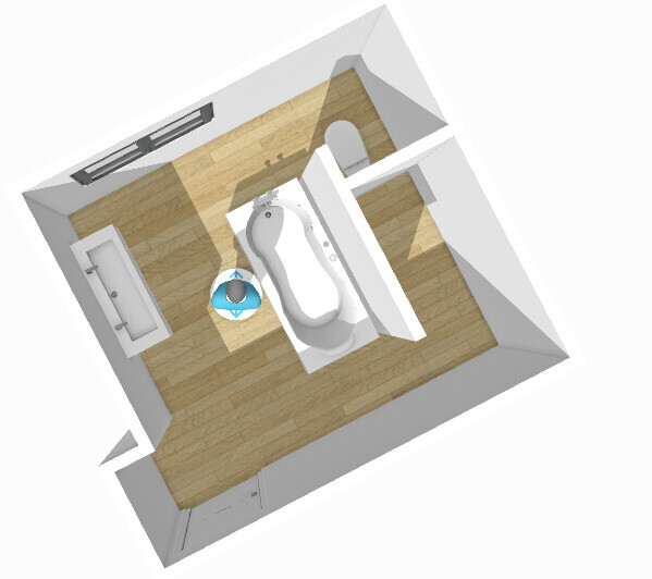

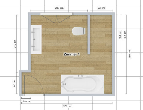

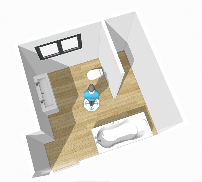

I quickly sketched this using the same measurements... The shower screen is shorter, and the seating area is quite uncomfortable. The bathtub with a length of 180cm (71 inches) hardly has any space. There is no room for a platform for sponges and brushes or a stack of towels.
