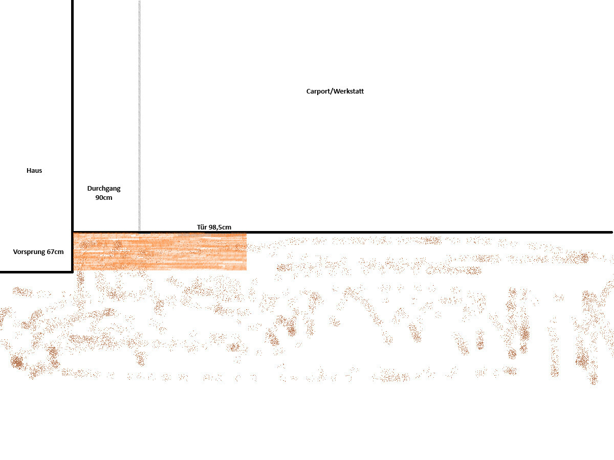

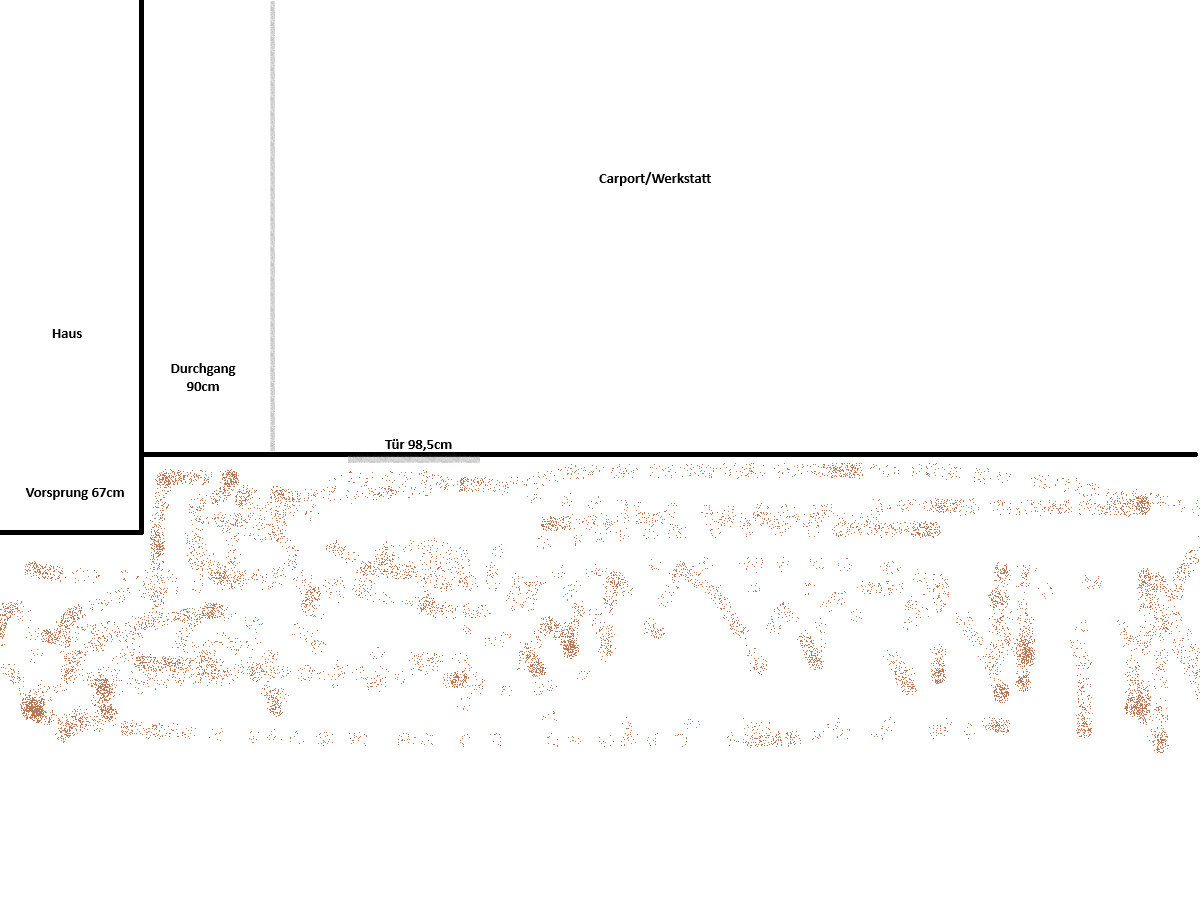

I have a double carport with a workshop inside. The carport is not flush with the corner of the house but set back by 67cm (26 inches). Now I have the problem that the workshop door is not weatherproof during heavy rain (Cuxhaven, North Sea). The first two pictures illustrate the original situation.

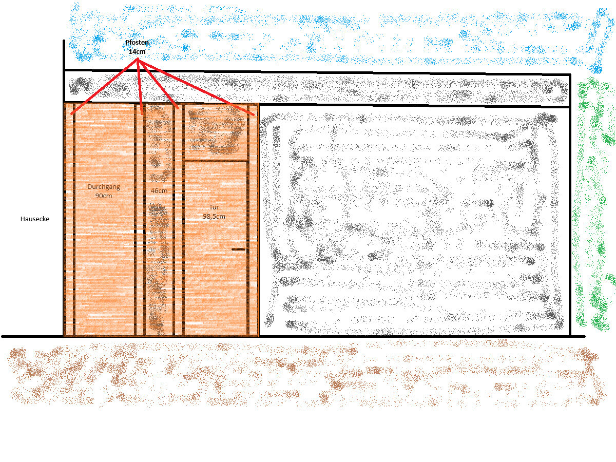

I would now like to build some kind of windbreak (marked in orange) in front of it without extending beyond the house corner line. I imagine something like rhombus cladding or similar. Not completely sealed, but at least shielding against the rain.

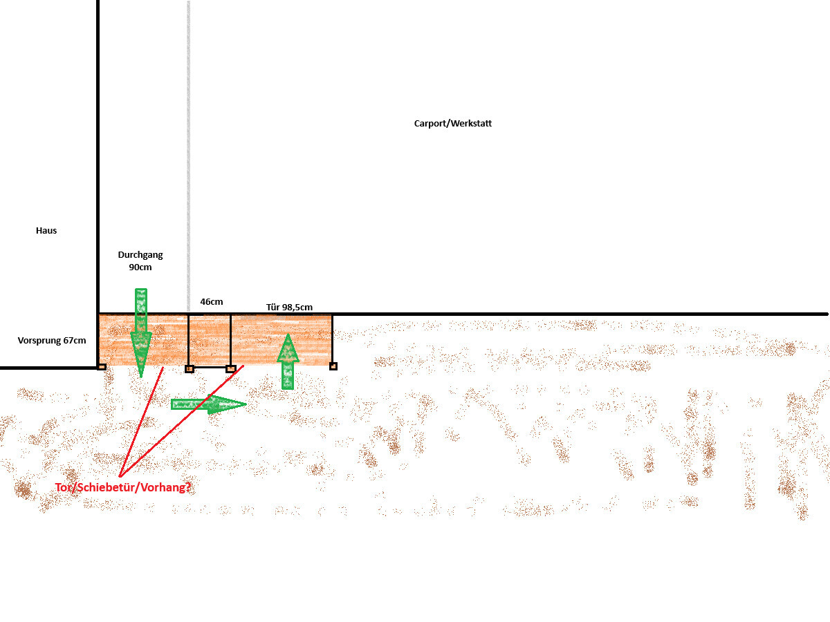

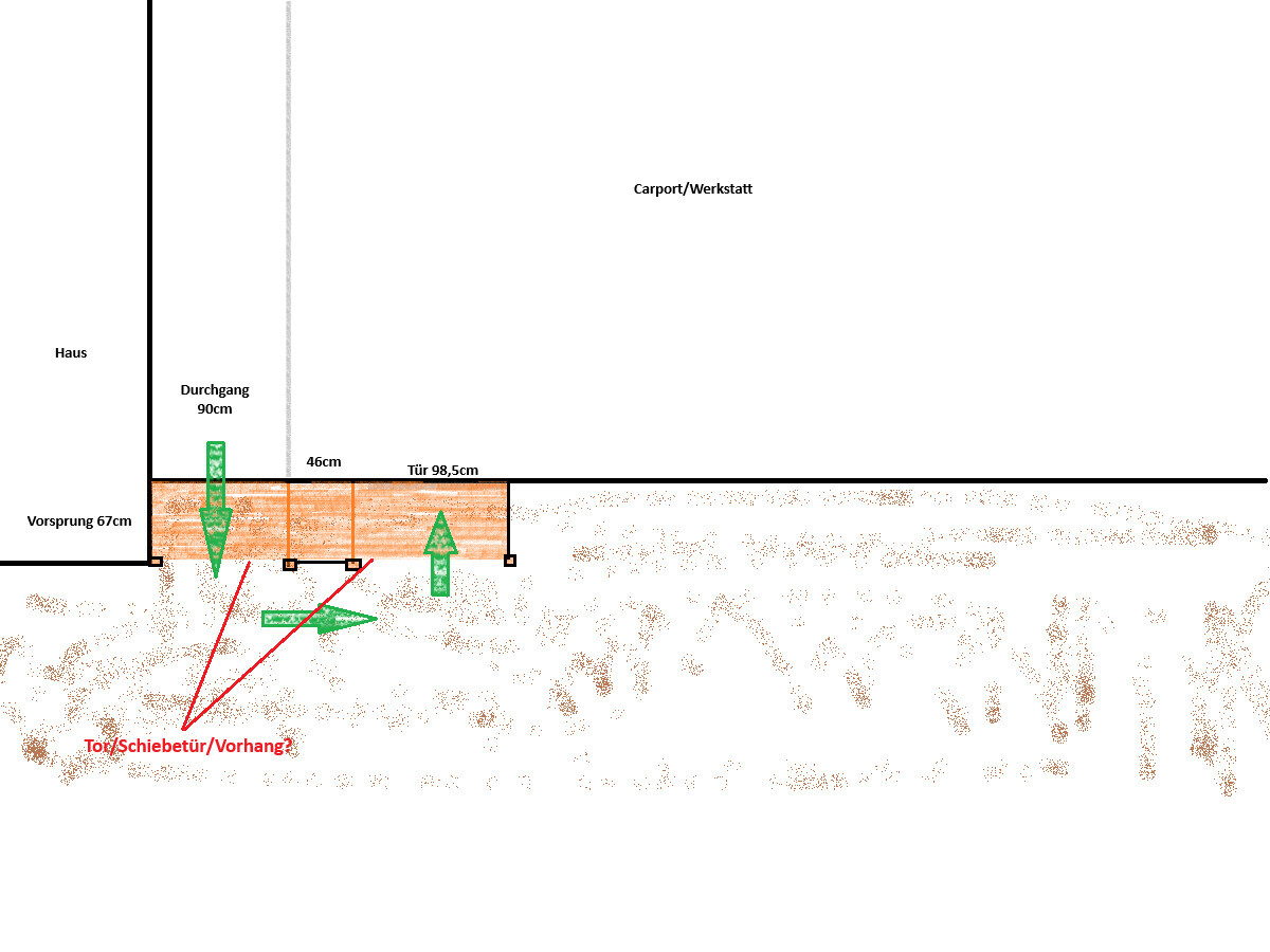

This windbreak/awning, however, will only be 67cm (26 inches) deep. Of course, that is not enough space to enter the workshop with bicycles, for example. That’s why I’m looking for an idea on how to design the new front of the windbreak with two lockable passages (green arrows show the path to the workshop entrance).

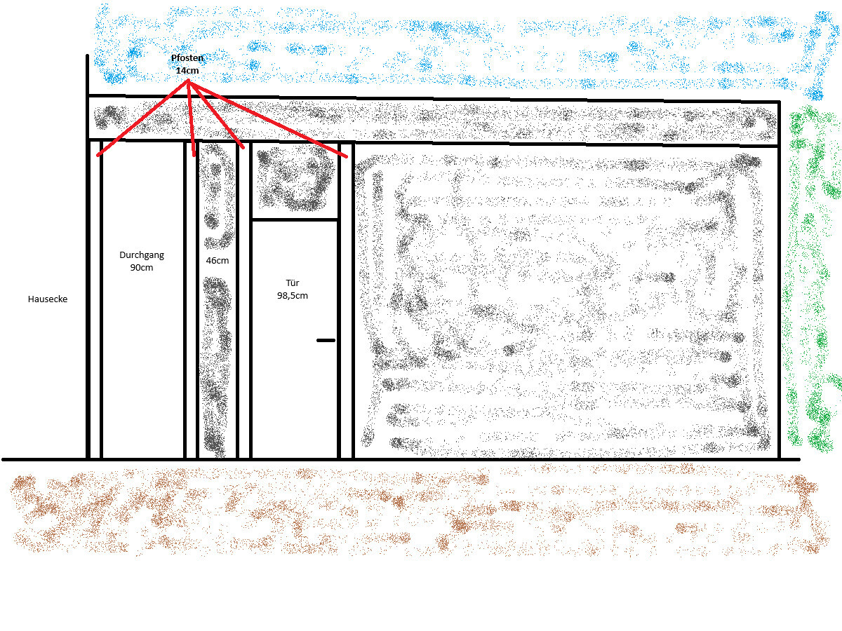

The problem: the depth of only 67cm (26 inches) is not enough for two new doors of 90cm (35 inches) and 98cm (39 inches) to open towards the carport and the workshop door. Both doors would have to be double-leaf, which makes them less stable. Sliding doors are also difficult because the only fixed section is the 46cm (18 inches) wide space between the doors plus two posts of 14cm (5½ inches) each.
Honestly, the only remaining option I can think of is a wind curtain. It could be slid left, right, or even to the middle and hidden away. But it would still need to withstand some wind when closed (Cuxhaven, North Sea).
