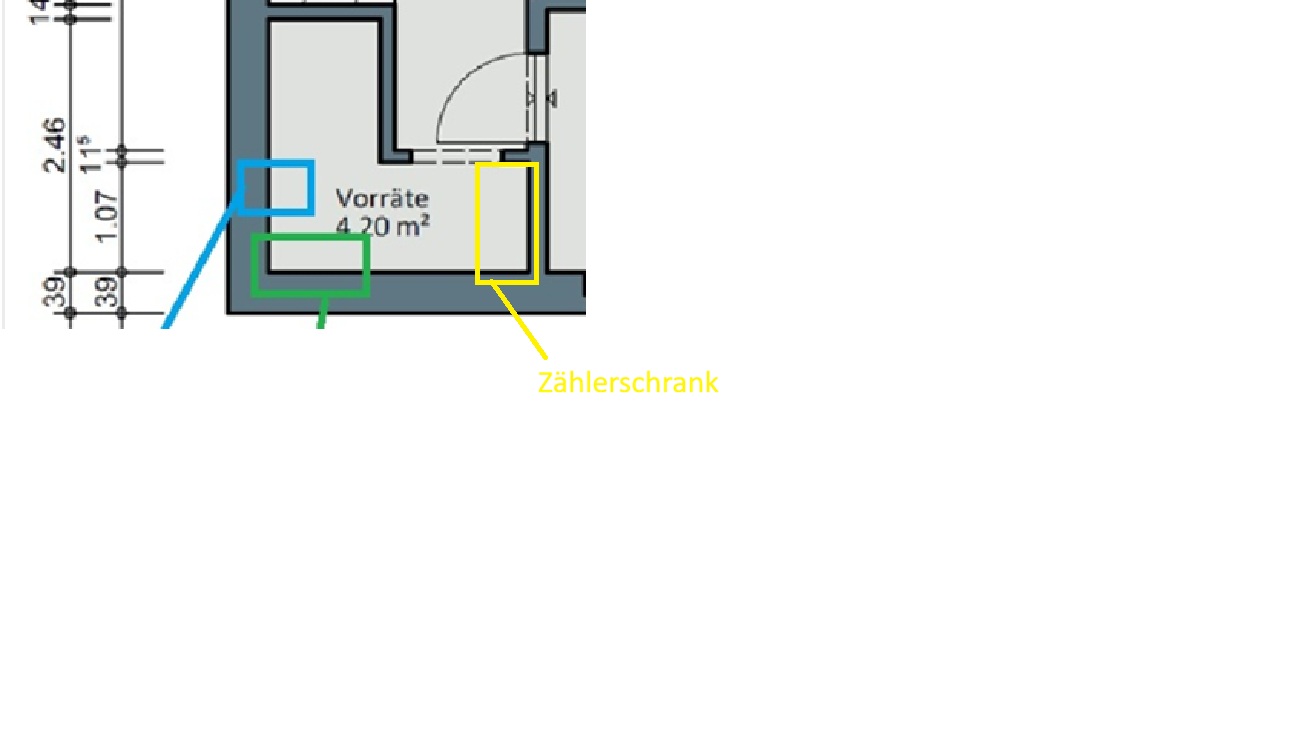

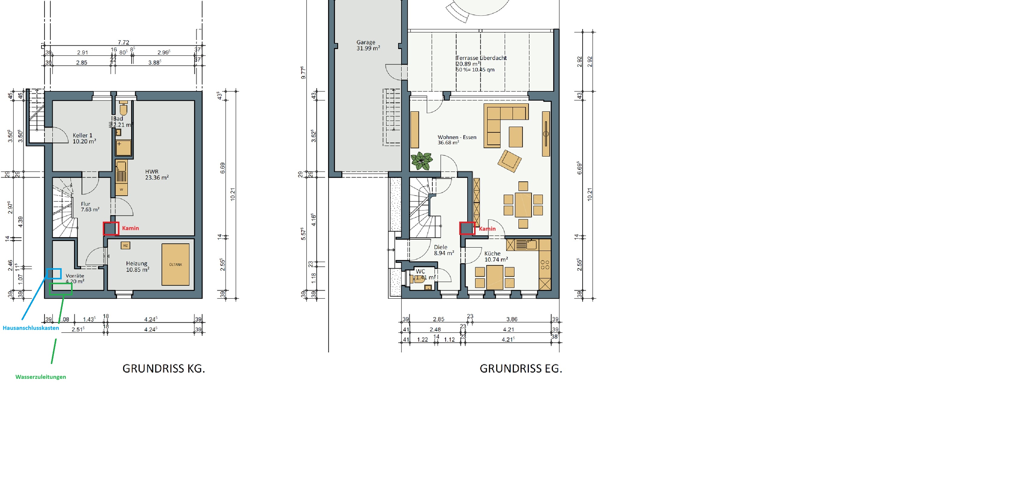

Thank you for the feedback.
I have marked the main electrical connection box in the floor plan at the bottom left. The utility company does not allow relocating it, and the technical connection conditions (TAB) only state that the meter cabinet must be located nearby... whatever that may mean, it seems to be open to interpretation :-)
The main electrical room is relatively small, so I was considering relocating the meter cabinet.
“Immediate vicinity” – usually we are talking about 1–3m (3–10 feet) of cable length between the main connection box and the meter panel. Anything beyond that is quickly scrutinized, even if technically longer runs are possible. If your utility room is already tight, an external cabinet only helps to a limited extent, because you then extend the main cable run, and that’s where the requirements are strictest.
I would rather suggest placing the cabinet at the edge of the utility room and running the cable straight up from there, so you move just slightly out of the room but still within the acceptable tolerance. Anything else will just cause more discussion later without much benefit. And honestly, if you save 5m (16 feet) per floor, that advantage quickly loses its significance.
I would now choose this spot for the meter cabinet. See picture.
The main electrical connection box is not far from there, and you would have roughly 1.5m (5 feet) of cable length if you route it neatly.
From there, I could relatively easily run the cables through the ceiling into the ground floor.
Should I pull all the cables for every room on the ground floor through one spot, or would you run them on the surface in the basement and branch off to each individual room?
MachsSelbst25 Apr 2026 09:12As far as I remember, there must be a 1.2m (4 feet) workspace in front of the meter cabinet. I would assume that installation directly in the doorway area is therefore not permitted...
