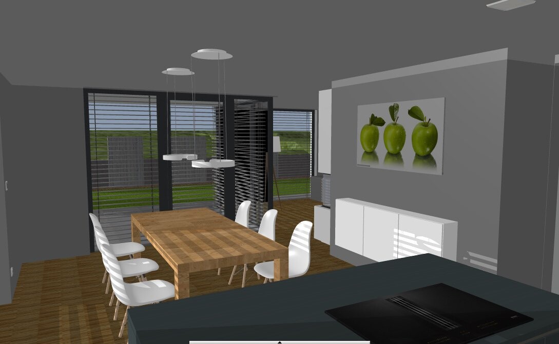

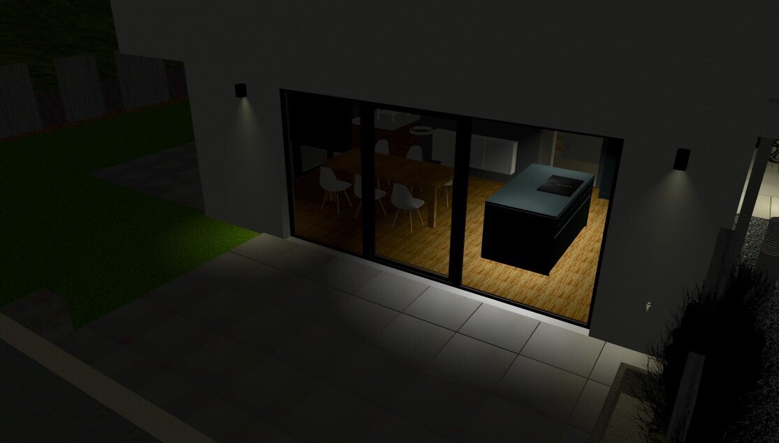

Anyway, to repeat myself, my current choice is cadvilla Prof. – it cost me just over a hundred (currency) and can do stuff like this:
Modern dining room with wooden table, white chairs, gray wall, apple picture, and window front.
Night view through glass sliding door: open kitchen and dining area with wooden floor and island.
Or with SweetHome3D something like this:
Modern bathroom with bathtub, shower, glass wall, and large windows with blinds.
Will that be enough for you? I don’t know. In any case, you must invest TIME (a lot) regardless of which software you start with, and you’ll have to experiment to build certain things. Every program has its quirks, and you discover them only through intensive use with many dead ends. Doors, windows, stairs are highly individual – hardly any single program offers them all. If nothing suitable is available, you’ll have to build things yourself, which requires knowing those tricks.
Regarding scalable furniture: SketchUp’s 3D Warehouse offers countless free models that are naturally scalable – why wouldn’t they be, since they’re vector-based, not pixel-based. Anyway, at least in cadvilla you can import many 3D formats, including SketchUp (skp), 3D Studio Max, AutoCAD (dxf, dwg), and several others. SweetHome3D also supports importing SketchUp models.
Many sanitaryware manufacturers (Laufen, Duravit, Keramag) and quality lighting manufacturers (for example, BEGA, Occhio, SML) provide 3D models you can import directly (dxf, 3ds). You’ll find many IKEA furniture models on SketchUp as well.
But start with a floor plan first; once it’s done, then furnish, texture, and light…
