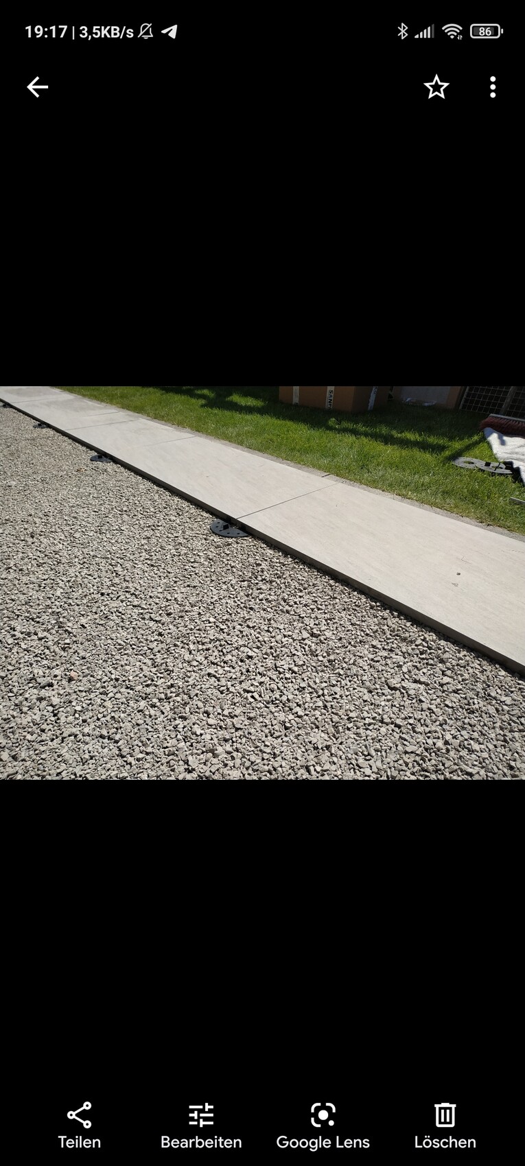

I don’t have any personal experience with this yet. I have only often read about it being a “disadvantage.” I understand. I think that for every decision you find a matching horror story online, and if you listen carefully because of these stories, you end up noticing things you would never have paid attention to otherwise.
At the time I was building, this was quite rare, but a friend recommended it to me. I found it and still find it great!
