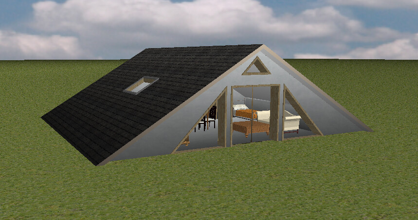

kaho67410 Feb 2019 17:30
Isn’t the bathroom window aligned with the entrance door? Unfortunately, I don’t remember the layout of the other floors.
Have I possibly rotated the roof slopes? No, right? The staircase is on the gable end, correct?
It looks a bit odd now because it’s only the roof. Also, the windows have the wrong pitch. But I hope it’s still clear:
A-Frame house with steep roof, glass front, and interior showing a bed
But you can decide which windows to install. These are floor-to-ceiling to allow maximum light inside.
Yes, there’s a kitchen line along the wall that turns the corner with an extremely deep countertop because of the roof slope. This was just drawn in quickly.
However, I would imagine the rooms like this: one large room, one bathroom, the storage area under the eaves, and partition off the rest.

kaho67410 Feb 2019 18:03
Ah, I see. Your hallway windows are on the other side.
It's really a pity if you don’t have a window on the bathroom side of the gable. I would have even made it floor-to-ceiling. But the view is also important. This can only be planned properly when all levels are considered together—either your architect will adjust it, or you'll just have to choose double casement windows.
Once you’ve started, the windows and their shapes should be finalized. They are custom-made to size.

kaho67410 Feb 2019 18:22
What do you mean by a light strip in the bathroom? If the north side remains as is, only double casement windows will fit.
The building authority is hardly concerned with the window shape. They would probably just find it strange if you suddenly had a completely different façade, I think.
