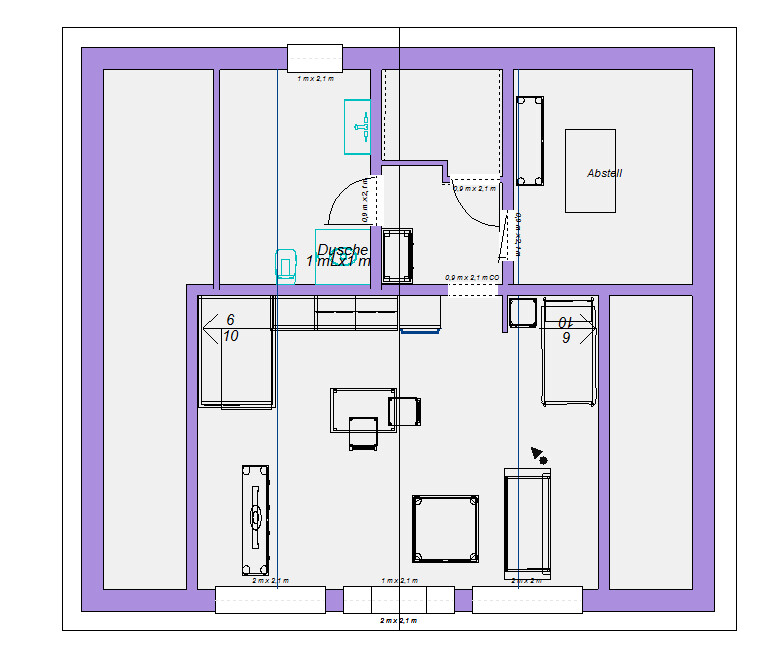

kaho67410 Feb 2019 16:47
Don’t underestimate the sloped ceilings. I also don’t see any division. It could, however, become a small attic room for the adult daughter or similar:
2D floor plan of an apartment with bathroom, shower, storage room, and hallway
